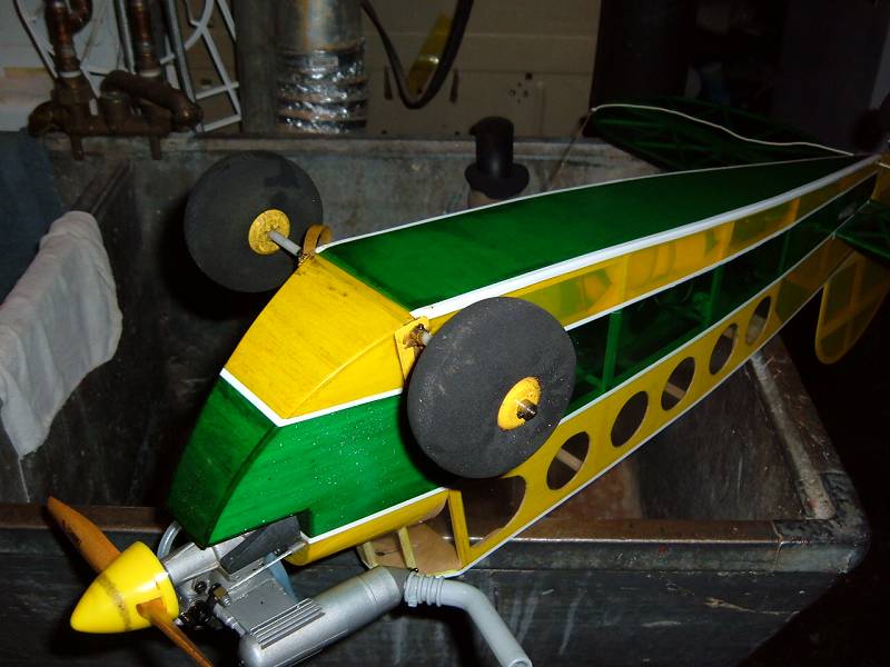

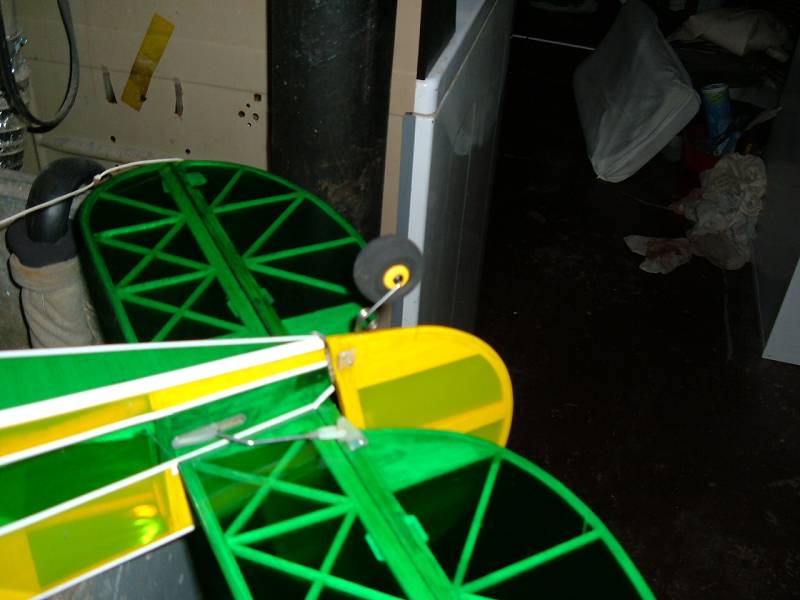

As a matter of fact I did sand down some foam wheels and they work great. I got some Dave Brown 4" wheels (two packages, four wheels), the big square ones, pulled (more like broke) the plastic hubs out then guled two together with Zap a dap a goo. I then chucked the wheels in my drill press, then spun the corners off until I had a nice round wheel. Painted the Trexler hub and pushed it inside the wheel, they look pretty good. I did the same thing with the tail wheel, although I don't remember what size it was.
I don't have any before and after weights. I know they weigh a little more than the original Trexlers but not much. Certainly nothing noticeable while flying. I flew with them most of last summer and they are working fine.
Sorry for the dirty plane, it's next for "Spring Cleaning".

Bolar, they look great, I didn't think about putting them on a Trexler rim, but it's a good idea if you not a scale guy. I plan to use them for a 48" Super Cub using the rim they came on. How well do they work on rough ground? I imagine there is little bounce. My gear will have scale suspension which should work well.
It's too bad the wheel makers don't make a foam wheel that looks like the Trexlers instead of the flat sided ones. Does anyone know what type of foam they use for making these tires? If we could get some wider we could make our own balloon foamy tires.
I fly off a grass field so I don't notice much of a bounce on landing. Anyhow, a bounce is a bounce and the wheels don't make much of a difference on a bad landing. Since your putting a working scale supspension in, that is what will keep you from bouncing more than the wheels.
