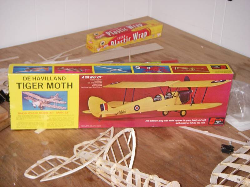

Ok so I'm a sucker, but I bought this vintage (late 70's) Tiger Moth on, of course, Ebay. It's got a 33 inch wing, supposed to be 4 way kit (yeah, right!). Of course, I'm going to rc it.
Well, I got 1st glue on it tonight. Started the upper wings. I have to laugh at the alleged "die cutting" this model barely has the part outlines die cut! And when you look for parts on different sheets, you find some so soft they cut like butter and others made out of balsa that cuts like PLYWOOD! OMG what have I gotten myself into?? LMAO!
Anyway, I can see that this build is not going to be quick, and it's going to take a lot of thinking (sheet plans and not much use) and engineering to install the rc components, but I'm up to it. I have a few brushless motors and I think one of them will be a fit. Probably be a good thing to go electric with this model. Less vibration and no greasy mess!
I'll post updates along the way. I'd love to hear from anybody with comments or experience with this or similar models.

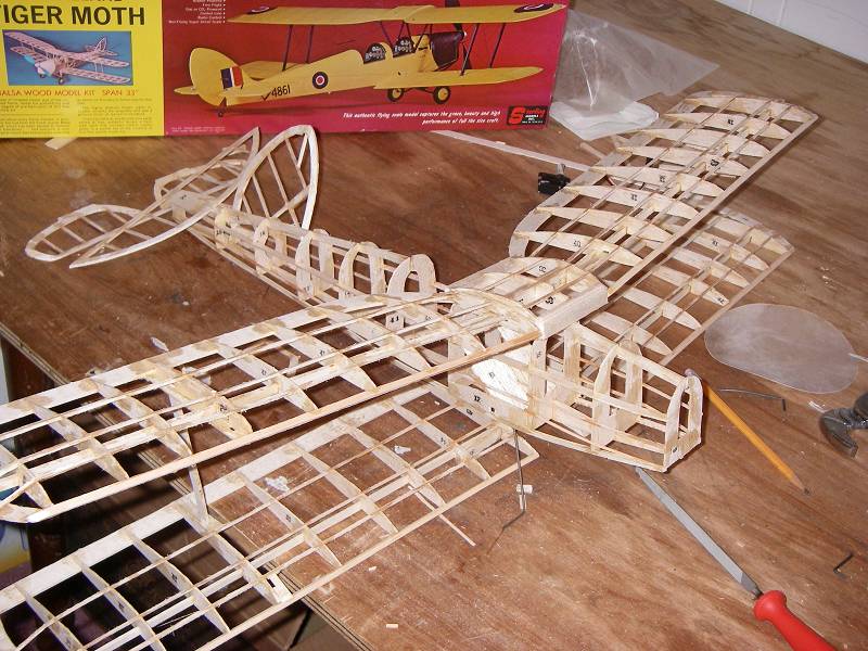

Well, I've been doing a little bit of work here and there. Making progress on the wings. I can't believe how tedious cutting the ribs out was! What a PITA! But they are all cut out and in place. I am in the middle of the glueing now. Once I get the ribs in place, ther are a few other small parts to glue and then the leading edge.
It's kind of funny, this kit is so old it keeps telling me to "let the glue dry thoroughly, preferably overnite." That's a throwback to the days of white glue!

Wings built. Elevator and rudder assembled. Flipped the plans over and starting on the fuse. Sure makes a guy appreciate ARF's!!!

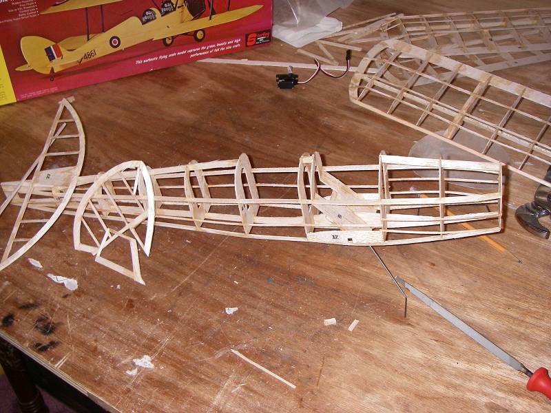

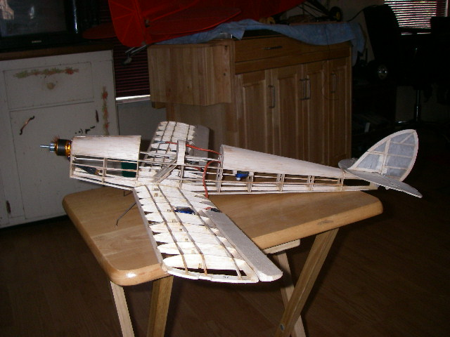

A quick update. All major structures are built, and the upper wing is joined. It ain't perfect, but it is close. I have ordered 4 new micro servos and have the build on hold till they arrive. I have cut the rudder and elevator as required for RC, and given serious consideration to the installation of ailerons. The problem with ailerons is that the lower wing will require serious attention to construct a trailing edge and then a leading edge on the cut off piece which will form the aileron. The suggested method in the plans won't work. It has both edges flat and vertical, which means no travel. Anyway, I'm thinking I'll buy aileron stock in balsa of the approximately appropriate chord. This will simplify the joint and halve the number of "edges" I have to build.
So there's not too much I can do until the servos arrive. I need them in hand to make mounts and determine the best locations for them. Once I have them I can check approximately where to put them for weight management. I can glue on the silkspan on the upper wing and tail surfaces, but can't cover the rest until I do the servo install.

Sounds like your having fun! Can you post some pictures please??

Let's see if this works..

Here's some more.

Looks really cool!! I would do the aileron mod, it shouldn't be that difficult.

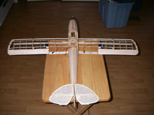

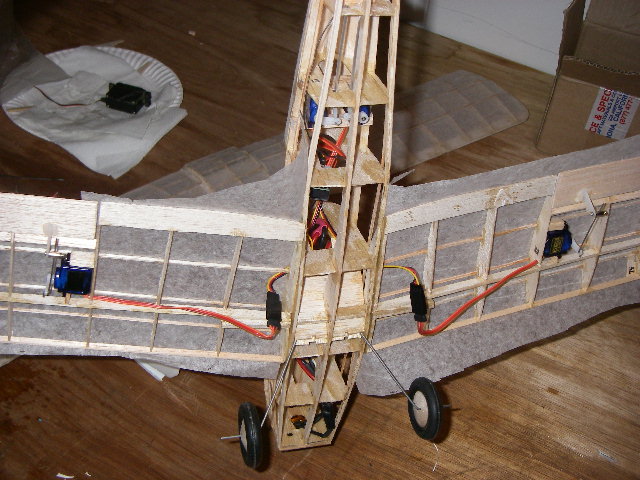

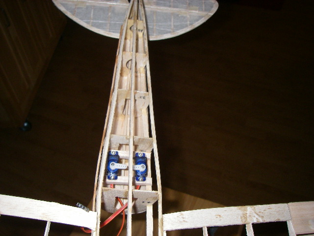

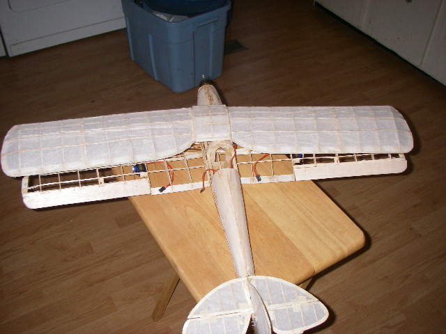

OK, it's November now. I have been neglecting this build, but thought I'd say hello!
I have done some other stuff, but recently I decided to mess with the Moth since it is cluttering up my work table. I have placed the servos-2 in the fuse behind the cabin, and one in each lower wing. I have done some covering the old fashioned way-white glue on the framework and slap the silk into it till it dries on wax paper. I have added the sheathing to the fuse.
I did do the aileron mod as you may have gathered from my mention of the wing servos. It was labor intensive, but I think it will be worthwhile if and when I ever finish this thing. But you know what? If I keep working on it, I WILL finish it. That's a big "IF"!!

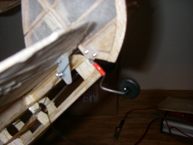

I have been moving right along with this Moth. The upper wing is covered. The rudder and elevator are covered and hinged and I am installing the control horns. I am waiting on an order which includes DuBro mini pushrods for the tail, and need them in hand before I can finalize their locations. I have epoxied the completed but not yet covered lower wings onto the completed but not covered fuse. I did my best at getting them aligned and the incidences close. There is a brushless outrunner screwed onto the firewall, and the plastic cowl has been cut, fitted and glued together. I designed it to be removable for motor access. Once I have the pushrods and tail feathers in place, it will be time to fit the upper wing and locate the battery, speed control and receiver for balance. After I have those decisions and installations in place, I will cover the fuse and lower wing and glue on the upper wing. Add wheels and prop and then we'll see. I'll get a few pictures in here soon. Meanwhile, any suggestions for a tiny steerable tailwheel? I have a few ideas myself, but anyone with a really simple idea I would love to hear from.
Old 11-23-2007 | 12:34 PM
Joined: Feb 2005
Posts: 596
From: Wallkill, NY
Default RE: Sterling Tiger Moth build
Here are the pics I promised. I have attached the tail feathers now. There is a shot of one lower wing with it's servo, and the 2 servos in the fuse for tail control, as well as a pic with the upper wing laying there. It's coming along.

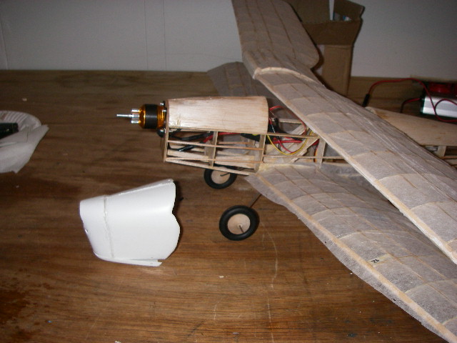

So now Christmas is approaching and the weather outside is frightful. I have abandoned deer hunting this year and instead have been building the backlog of ARF's I have accumulated over the years, including an Accel profile Pitts (chronicled in it's own thread) and a yello P 51 with retracts that I think really came out AWESOME for a no name Chinese kit. Or maybe my building skills are getting better? Who knows. The Pitts flys GREAT, but I haven't flown the 'Stang yet. Bring on the Spring!
Back on topic, the Tiger Moth is moving along. I spent a few more hours on it installing the tail feather pushrods and a tailwheel. I decided to go ahead and use the wheels (main and tail) that came with the kit even tho they are heavy just for ha ha's sake. The instructions kind of leave you up in the air on the tailwheel install, but they do give you a piece of wire to bend into shape. So I bent it and put it tho a short length of pushrod tube which I glued into a groove I carved on the very end of the fuse. A dob of glue on the top and the bottom of the wire gave me a serviceable free moving tailwheel. After observing that the top of the axle was very close to the forward edge of the rudder, I added a bit of glue there tying the tailwheel to the rudder and thereby creating a steerable tailwheel. We'll see how long it lasts.
With all servos installed it was time to wire up the esc, add the receiver and battery and see if it all works. It does! I thought it might be cool to taxi the naked plane around my kitchen floor for a bit, and I was right! LOL! She seems to want to go. Now it is time to finish the covering, install the top wing, shrinky dink the silkspan and shoot it with some paint. At this rate, come springtime she might be ready to maiden! Here's some pics I took this morning. And a shot of the Mustang.

Today dawned cold, but calm. I have completed the Moth, except for the paint job, and I decided to see if it's 1st flight would also be it's last flight before I bother painting it. LOL. Long story short, After a long ground run I got it off the ground, and it flew! Not far tho. I put it down and did it another few times. After that, I didn't seem to have enough power and couldn't get it off the ground. I am not jumping to conclusions yet about whether there is enough motor or battery power. I THINK there is, but I am in no way shape or form knowledgeable about electric. It is a brushless, 1080 kv and I have a 2 cell 900 ma lipo to power it. I was running a 7 by 6 master airscrew glo prop direct drive, and in my kitchen taxi testing it sure seemed like it would do the job. It's possible that I didn't have a full charge on the batteries, so I am going to make sure they are fully charged next time and also I have up propped to an 8 inch e prop. Hope that makes a difference. Comments from the peanut galley are encouraged. Happy New Year everybody!
Old 01-05-2008 | 09:25 PM
Joined: Feb 2005
Posts: 596
From: Wallkill, NY
Well, the tailwheel didn't hold up. I pulled it off and glued on a piece of wood as a tail skid. I changed out the wheels for a pair of reallly light weight ones, and perhaps most importantly, I put on an e prop that is an inch longer and also has a wider chord. If I can get my butt up tomorrow early enough, and it isn't too cold and windy, we shall see if it will fly.

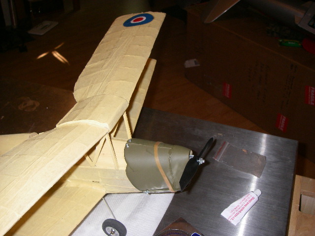

Final post, with pics.
After a few flights, each one better then the last, I decided it would be worth painting. I sprayed a few coats of yellow on her, and did the cowl in olive brown. I enjoy flying her at my small field local HS with a group of mainly small electric type guys. I don't miss having a tailwheel, she steers fine on the ground with the big old rudder. The ailerons work fine, and she likes a touch of rudder in the turns. I will enjoy it while it lasts!
Not sure why the color looks so washed out. It IS yellow.
