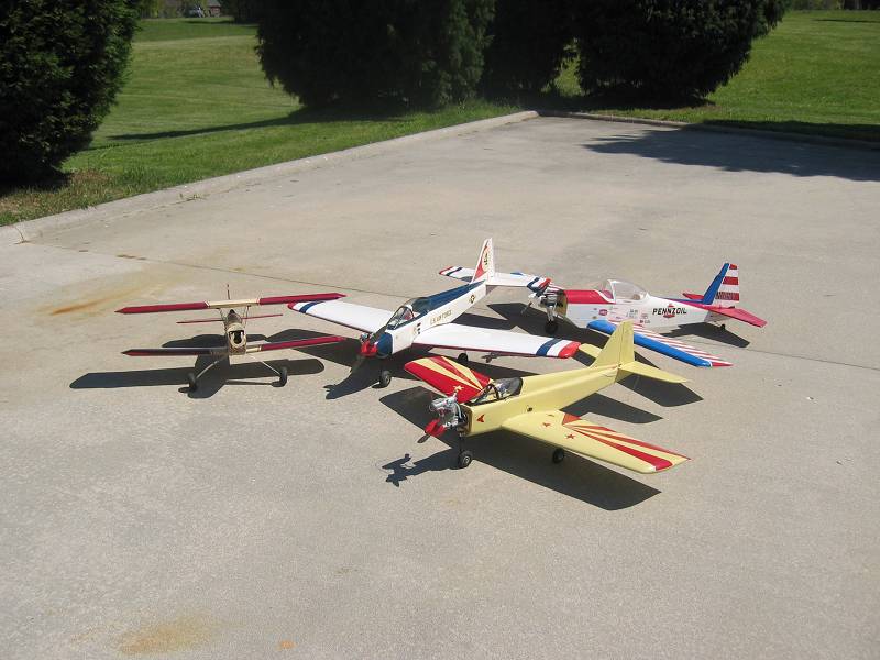

King Cobra
Eliv 9/16
Rud 1 5/8
Ail 1/4
CG 5 5/16" back from wing fuselage joint.
Cougar
Eliv 3/8
Rud 1 1/4 - 1 1/2
Ail 1/4
CG 1/2" back from the leading edge at the wing tip.
I have a King Cobra and several Cougars. After rereading the information wasn't very clear.
Bill
