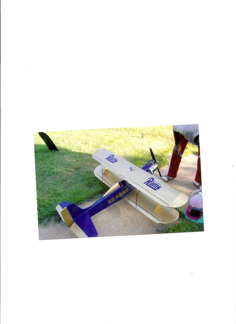

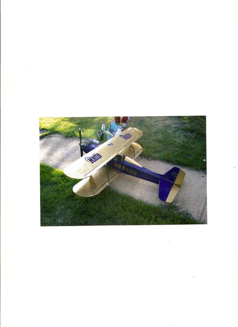

HELLO PREACHER THE kit is very easy to build . I just got one off the board it took about seven days to build. I think you will injoy it . happy flying heres a picture of my bipe

Hey thanks for the tips guys. Have been to the web site that you suggested and it is a good one. I will probably make most of the mods mentioned, especially the double servos for ailerons, and the landing gear.
Hey DJ. Rams Hog looks great! I am from S.W. Mo. but am more of a Chiefs fan, maybe I will do mine in a Chief Hog scheme!
