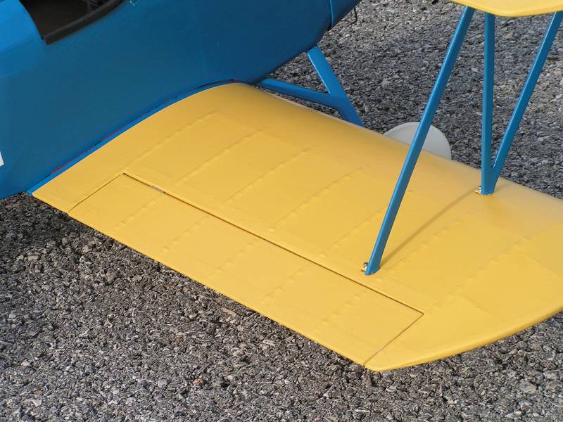

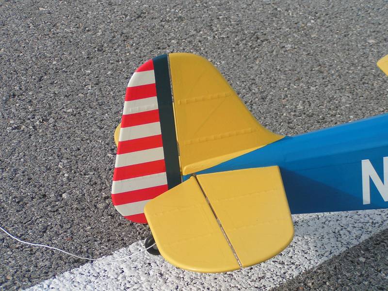

For covering I used Dave Brown Skyloft, and sanding sealer instead of the dope mentioned in the instructions.
I read many negative comments on this covering material, and I disagree with all of them.
I wanted a doped-on light covering (it simply stays "as new" even after many yearss with no bubbles or sagging developing) and since tissue is not puncture resistant enough for such a model, I went for this which is basically nylon covering, hence extremely strong.
I have also used it on a 1/3 scale model. It's very light, very cheap, but requires some careful application per the instructions. If you are experienced with silk and tissue covering, and/or are prepared to learn this technique, I highly recommend it.
I also simulated rib stitching and rib tapes, using two layers of plaster tape from a pharmacy (I hope this is the correct English term for this, but you can see it in the picture), and some nylon fishing line for the "stitches", trapped between the two layers.
Then after application to the model, I added one more layer of tape slightly wider than the previous, and this was the "rib tape".
The important thing is to have the correct "pitch" of the stitches per the model scale. I think the real one has a pitch of 2" so I calculate based on this.
For paint - I brushed on polyurethane paint, since I have no spraying facility.
Use a good brush, well thinned paint (such that requires 3 coats just to see the pigment, and 6-7 coats in total...).
It isn't "Top Gun" quality but OK.
