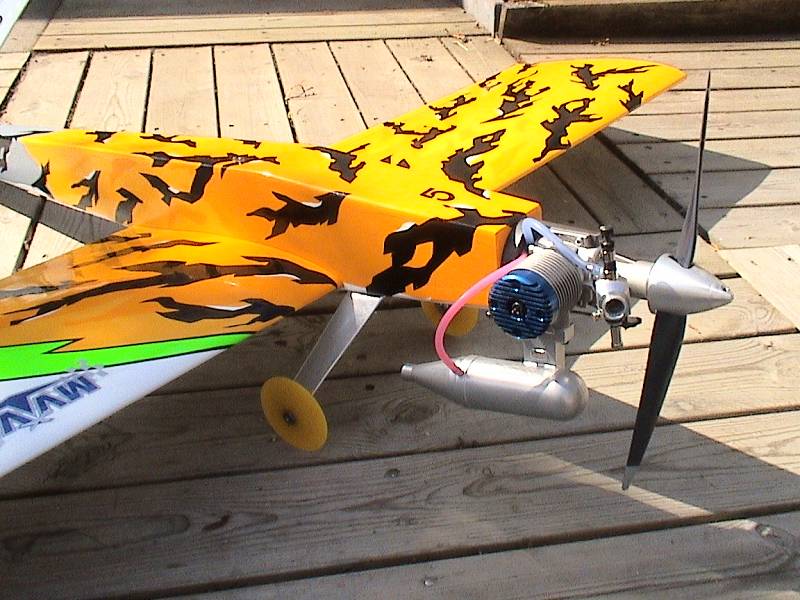

I most of the time drill and tap my mounts...the exception being plastic mounts where just drilling and using machine screws work great. Use this in many of my Q-500 airplanes in combination with Bob Brown plastic engine mounts.
Rubber mounts is not needed!
