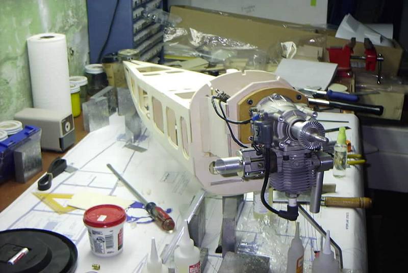

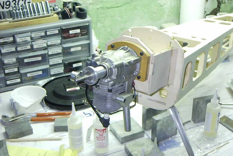

I made my engine decision going with a Zenoah G23. It's "used" but just barely and it bolted right up to my modified firewall, nicely.
Sweet kit...I CAN see why Midwest complained about how expen$ive it was to produce. You cannot believe the scrap lite ply and balsa left over after primary construction! I believe it was cutout in Italy, probably by Falcon Trading. Today, laser cutting could consolidate the amount of wood required for the die-punch process, I'm certain. As it is, it is-was state of that art, lol...

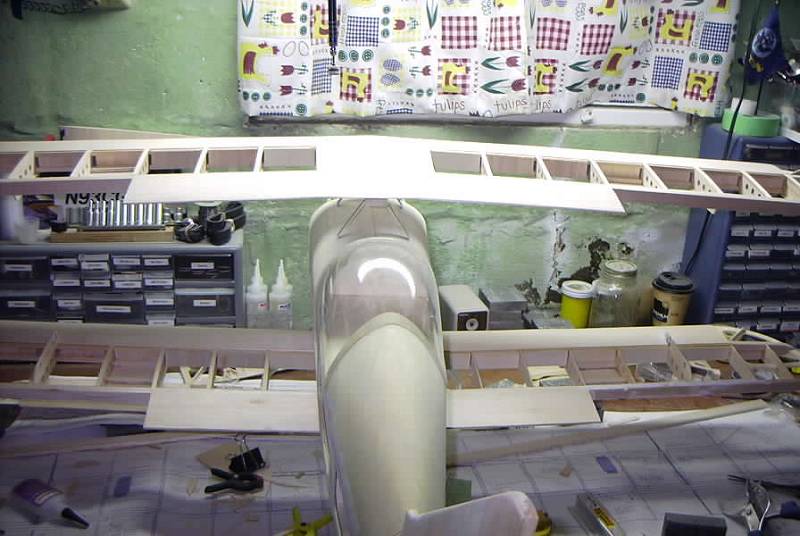

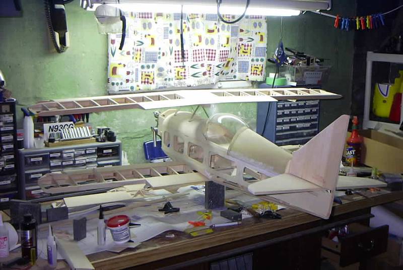

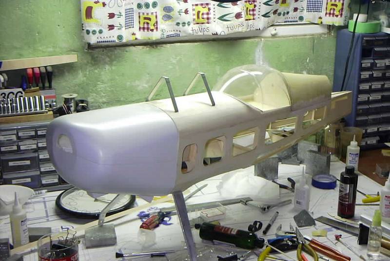

I still have a lot to do but thought I'd post some up-to-date photos as she is so far:

Back at the bench, the G23 was removed and essentially, I tore down the radio install and removed both tanks.
A US Engines 41cc is being used as an upgrade for power. Naturally, the carb is on the opposite side, necessitating a throttle rethink as well as a rerouting of fuel lines.
Being 16oz heavier than the Zenoah, my tail heavy mystery will be solved as well as the thrust to weight ratio challenge caused by the smaller engine.
The firewall required removal of the blind nuts and throttle cable. I disco’d the smoke lines and measured for the re-drill. I actually cut a “second” firewall from 3/8” birch and am laminating this behind the primary. A full ¾” now supports the heavier engine. I know this is overkill but I fly my planes hard and while concerned about weight, I do not fly IMAC or 3-D so unlimited verticals aren’t a worry.
This replacement engine uses differing bolt architecture so blind nuts won’t be used again. ¼-20 steel hex-head bolts will feed through the rear of the firewall and into the threaded rear housing of the engine. No nuts can be applied so lock washers and “red” Loc-Tite is the order of the day here. 30 min epoxy will be used to laminate the doubler to the firewall. All access holes will be sealed with thin CA.
Fortunately, removing the gas tank revealed pinched tubing and reinforced my decision to redo the fueling method.
