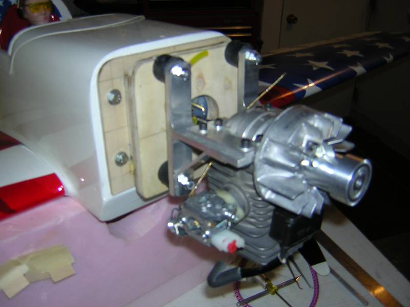

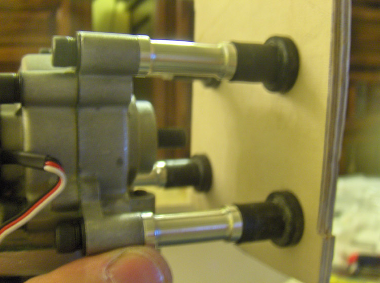

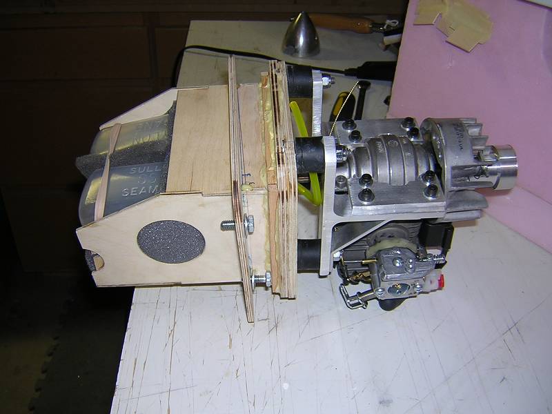

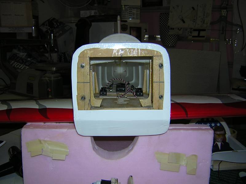

There are many instructions online for many different types of anti-vibe engine mounts. RC Report had an article mid summer 2007 of a 'false' firewall using fuel tubing and silicone. However, I think the ticket for you is the same as what I did on my Byrons CAP 21. I went to a truck dealership and asked for Freightliner grill guard mounts. They are about 3/4 inch thick rubber, maybe 3/4 inch diameter with independent 1/4 inch standard thread studs protruding from each end. These studs are imbedded into the rubber, secured by washers buried in the rubber. The studs are not attached to eachother, making for totally independent rubber mounted studs.
I would post a pic of these, but my camera was stolen (found, but not returned yet per trial). I can give you these pics of my CAP's building progress. These are very easy to work with, and can be mounted directly to the engine mounts, or with the use of another firewall.
Or any other type of mount your imagination can muster.

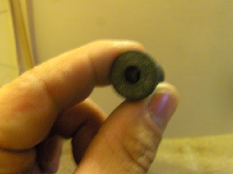

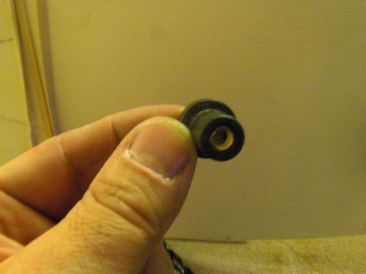

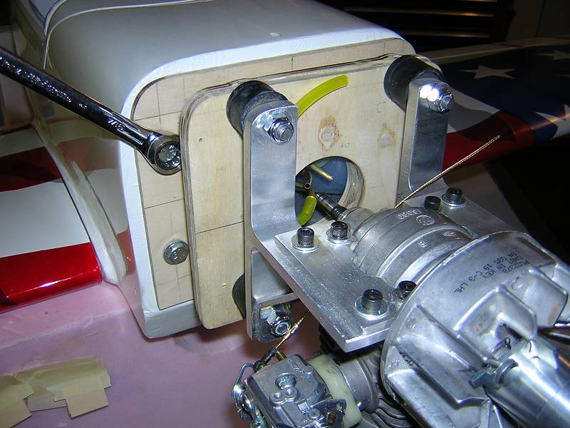

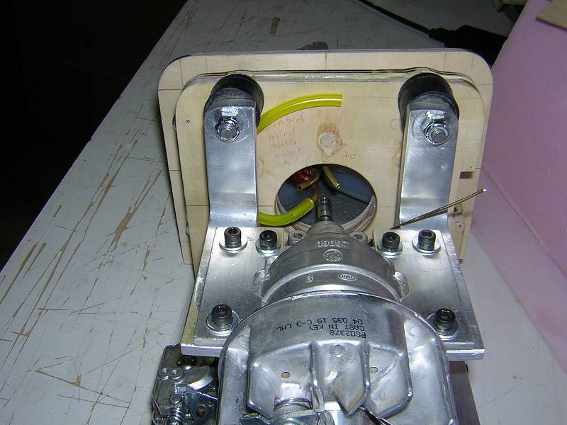

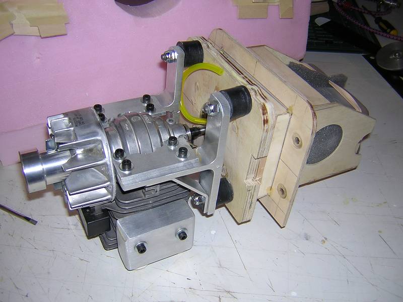

These mounts were used for a 45cc homelite gas conversion. They show no signs of failing. If they can hold a 400 pound grill on a truck, they can hold an engine to your plane. Some more pics:

Dan,
Those are fender mounts you have there. I have a friend that successfully used them on a gas engine a bit bigger than yours, but he used an aluminum 'false firewall' so the brass inserts could not pull through. Can't remember how he did exactly, as that plane died a horrible death.
I wish my camera wasn't stolen from me, or I could show you exactly what I have. I will attach a cheesy paint drawing to explain it further. The the silver is the steel,the black represents the rubber, which totally encapsulates the stud's anchor washers. Notice that both studs are independent of each other with only rubber connecting them. I have noticed that some rubber mounts are harder rubber than others, so dig around in the bag for the gummiest ones for that size engine.
