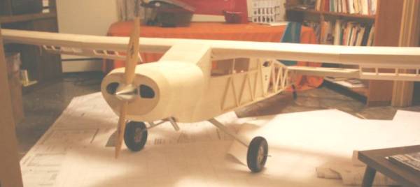

Default Getting closer!
Well, it is getting a bit closer. I had to do a bit of mods on the snout to hide the Fox 4.8 twin! This thing is a ball to build!

Old 06-26-2003 | 02:22 PM
BillHarris's Avatar
Joined: Dec 2002
Posts: 837
From: Jasper, AL
Default bte super flyin king
Bravo. It looks great! The cowl is a nice addition.
The only thing bad about a BTE kit is finishing it... it looks so good "in da bones" that you hate to spoil the looks of the wood by covering it! Bruce's kits have to have the best wood selection I've seen.

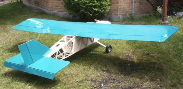

Default hated to start covering but :}
I know what you mean Bill. His stuff looks so nice in the bones.
But I had to start covering!

Old 07-03-2003 | 01:05 PM
BillHarris's Avatar
Joined: Dec 2002
Posts: 837
From: Jasper, AL
Yeah, but an FK looks for good in the
air...
Nice colors!
--Bill

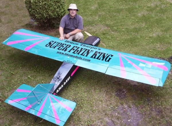

Default It is ready!
Well, I hope to do the maiden flight tomorrow! If it flies half as good as it builds, I am gonna love it.

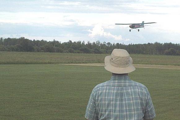

Old 07-12-2003 | 05:01 AM
My Feedback: (12)
Posts: 74
From: Baudette, MN
Default It Flies!
And man does it ever fly! It acts a lot like a big old Cub. After I quit shaking, I was able to really enjoy it.

Old 07-14-2003 | 03:50 PM
BillHarris's Avatar
Joined: Dec 2002
Posts: 837
From: Jasper, AL
That plane really looks good in the air.
Interesting that the rudder servo is mounted on the top of the tail ahead of the rudder. Pull-pull linkage. How is the tailwheel steered? I think I see some extar cables on the rudder servo arm, but I'm not sure. From 'da bones picture, I'm not sure where the elevator servos are. I don't know if this is a BTE feature or if the Good Friar was moving things rearward to balance the 4.8 Twin engine.
--Bill
Old 07-14-2003 | 05:05 PM
My Feedback: (12)
Posts: 74
From: Baudette, MN
Default Ya caught me!
Good eye Bill,
I put a Hitec 5735 on the rudder, mounted externally (Not according to plan), and a Hitec 545 mounted on the bottom with pull pull for the tailwheel. The Hitec 5735 for the elevator is just inside the tail. It balances that way without a drop of lead!
Old 07-14-2003 | 05:56 PM
BillHarris's Avatar
Joined: Dec 2002
Posts: 837
From: Jasper, AL
That is some good thinking about mounting the rudder, elevator AND tailwheel servos rearward.
At first glance, using a separate servo for the tailwheel seems odd, but considering the mickey-mouse setups we can use to connect the rudder and tailwheel, it may be a simpler solution. For example, on my (small) Flyin'King, my rudder servo is in the rear of the cabin (designed location) and operates the rudder via a Sullivan Goldenrod. An extra link goes from the rudder servo arm to a bellcrank, which has a pair of Kevlar pull-pull cables back to the tailwheel. That is a standard setup, but still complex.
Ya done good.
--Bill
