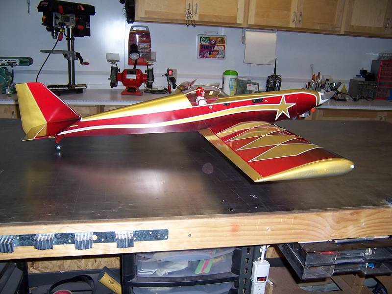

Finished modified Sig Four Star Fourty
I finally completed my Four Star 40 build.
Here are the Specs.
Wings clipped one bay.
Rounded wingtips added.
Wing fully sheeted.
Air retracts, Robart 605s, Dave Brown wheels
Fuselage covered with .007" fiberglass sheet G10 (FliteSkin).
Vertical stabilizer and rudder re-designed based on Bruce Tharp's Venture 60.
Dubro tailwheel
Cut down canopy.
Fully tapered control surfaces skinned with .007" G10.
Fiberglass cowl from home made mold.

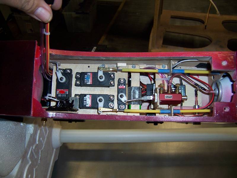

Two aileron servos.
DIY wingtip nav lights, strobe on fuse and two landing lights.
OS50SX
Spektrum AR7000 receiver
Golden Rod control rods for rudder and elevator.
Auto Air automotive poly paints with waterbase polyurethane clearcoat.
All up weight dry, 7lbs 2.8 oz.

Yes give report!!! can you send more info about your choice of paint ? Is it fuel resistant? I am doing a extra 300 build, fibertglass fuse and all and about to the point to start painting. Not sure what motor to out on it. how did you prep the monocoat ? great job on that plane!!!!
No plastic coverings were used in this plane.

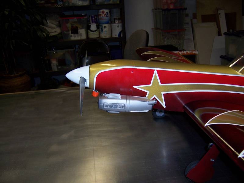

The paints are automotive airbrushing paints (Auto Air brand). I used red metalic, gold flake, opaic white and translucent black. These paints require a reducer (actually two, one formulated for the metalics, and one for the translucent) They are not fuel proof and need to be clearcoated. Ideally you would use an automotive two part clearcoat but the cost of the smallest quantity would be in the neighborhood of $80, so I use exterior water based polyurethane paint from the hardware store. The metalic gold was the most expensive at around $16 for 4 oz followed by the red at about $14. The black and white were around $11. Not the cheapest way to paint. I used a small HVLP spray gun and an Aztec airbrush. I used the transparent black to create a fade on the red. I think I should have used more reducer to get a finer transition. This was definately not the cheapest way to paint.
The clearcoat is fuel resistant so the plane will need to be cleaned of fuel within an hour or two.
I hope to maiden this weekend. It just started raining and it's predicted to be off and on all week. I built this plane for a couple of reasons. First, my former (and much more stock) 4 * crashed from reversed ailerons after getting my radio back from repairs (forgot to reverse the servo). Second, I lost confidence in my previous radio (Polk) and I fly at a very busy field so I got a DX7 and wanted a plane to put it in and get used to before putting it in my TF Spitfire. Third, I figured if I set it up with retracts and if it was a bit on the heavier side, it would be good practice for heavier wingloads of scale warbirds. Finally, I just gotta do things different. I'll keep you posted on the maiden.

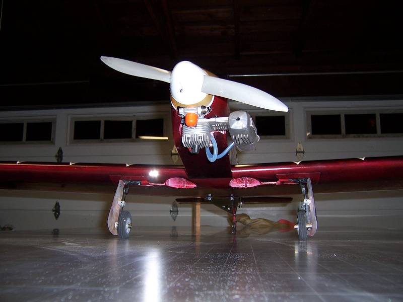

Awesome build Scott. I'm planning on getting to my 4*60 and have Robarts that I was thinking of adding to the plane. Do you have any pics or steps/tips/lessons learned you could supply of your retract installation.

For the gears, I added ply doublers to the two ribs that support the rails forward of the spar. I cut the rails from maple. I also added ribbletts forward of the spar on both sides of the wheel well. To be honest, I don't recall exactly how I figured the forward rake and the angles of the rails. I do recall having to make small adjustments as I installed the rails. Also, a fair amount of the work was done after I had sheeted the wing. It would have been much easier if I had made the decission before hand. The same goes for running the nav lights. I had to pick up a long drill bit at harbor freight and drill through the wingtip and all the ribs one bay past the retract. Then I drilled through the other ribs from within the retract and wheel well. The holes lined up well enough that I was able to use the inner part of the original plastic pushrods to fish the wires through. The gear doors were fairly simple as the wing is constant from root to tip. I taped some ultracoat over the wing and layed up several layers of fiberglass large enough to cover the wheel wells and retracts. I then cut the gear doors and hatch covers for the retracts for a good close fit that matches the curvature of the wing.

I considered buying a cowl as I believe that there is one available from one of the third party fiberglass parts suppliers. But I decided to try and make my own mold. It was mostly successful. I have a mold and could make more cowls if needed, but my plug was destroyed in the process (it wasn't polished well enough or waxed well enough and stuck in the mold. It was made from balsa blocks, so I just chunked it out of the mold.
