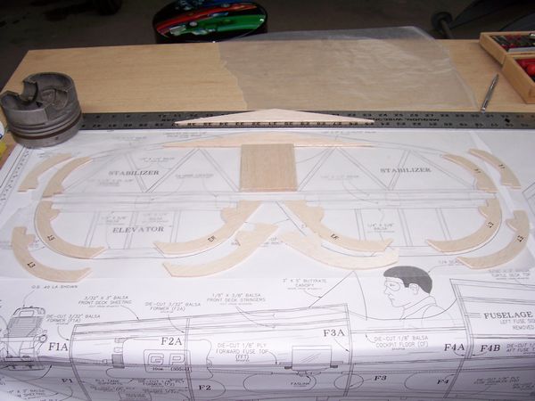

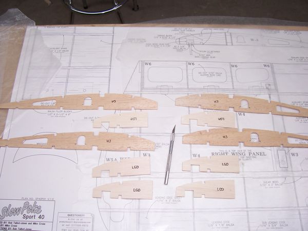

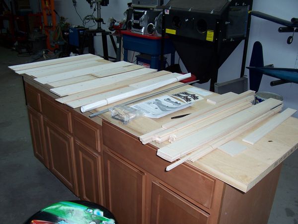

I know there has been several SlowPoke builds before , but it`s winter time and what the heck , here goes.
Laid the kit out and marked all the pieces , and checked to make sure all the pieces were there. The wood in this kit is pretty good , as is the die cutting.
This well be my 7th build and I have recieved a lot of help from MinnFlyer , but did`nt want to bother him to much , so I inlisted the aid of Minnie Minn , You`ll see him in some of the photos, checking my work.

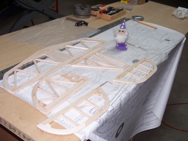

Have the tail feathers finished , they have been sanded to 180 grit and the hinge slots are cut. I just got a GreatPlanes eletric hinge slot tool and I love it. What a time saver.
Ken , I taking your advise and putting a 4 stroke in it. I have a Saito .56 and a Magnum .52 to choose from. Leaning towards the Magnum , because it weighs 1.25 oz. more than the Saito. What do you think ?

Robbie,
Go with the heavier engine. Slow Pokes come out tail heavy. I've seen builds where they needed 10-16 oz of weight in the nose. I was very carefull when I built mine and build the tail as light as I could, moved the receiver as far forward as I could, and put the battery under the fuel tank and I only needed 2 oz of weight to get it to balance. So a little heavier engine will help you out here. I used an OS 52 Surpass in mine which weighs 14.2 oz.

None that I can think of right off the top of my head. From my build that was the only thing I can remember that stands out in my mind, the weight issues.
I will note this. As you are building the wing it is going to seem "flimsy". Don't worry about that. It will strengthen up nicely when you cover it.

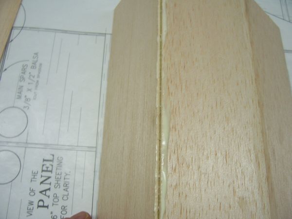

For the center section of the wing , you have to build two sheets 18x8 5/8 , using 3x 1/16 x30 balsa . I used Elmers wood glue to glue the edges together. After fitting all the seams , I used masking tape to hold the together, I then could fold them open , aplly glue and laythem flat to dry. Maybe my pics can explain it better.

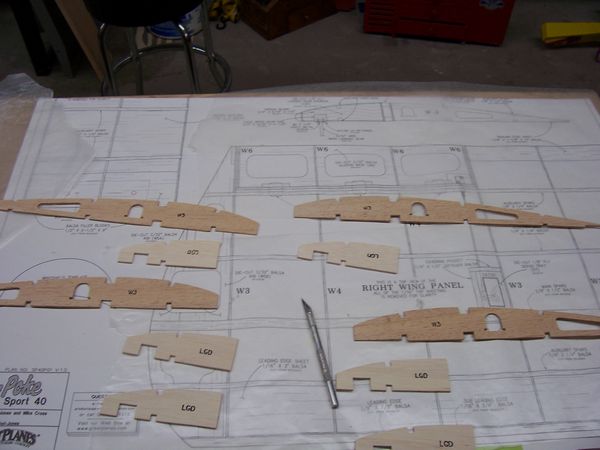

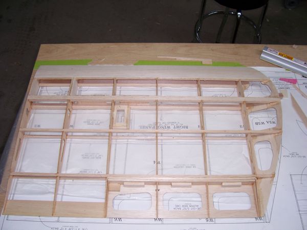

Finished the right wing panel , made 2 mistakes. Forgot to glue the torque block in and and over lapped the LE sheeting on top of the spar , instead of butting it up against the spar. Wonder if I should do the left wing to match , lol
The wing center section is done , I just need to install the top sheeting.

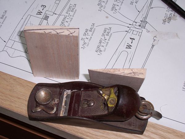

The little palm plane I have , sure make shaping balsa a breeze, not to mention kindling for the wood stove.
Ken , your right , the wing does seem very wimpy. Especially the wing tip . I`m wondering if I should`nt have made new ones out of ply ? I did put a little 30 min epoxy in the spots I thought were a little iffy
This is a little different type of building of the wing , than I`m use to . The right one should go faster. I got Dogfights the first season for x-mas and am watching it while I`m building . Slows me down some , but I love the WWll planes , and it`s great to hear the pilots tell their stories first hand.

Just a suggestion: To strengthen the wing tip, laminate two pieces of 1/16 balsa to the inside of the tip to cover the holes. Not much weight added for a plane of this wing area. Ron

Great to see this thread, I'm in the process of building one of these too. I'm only a little ahead of you, I've got all 3 sections of the wing done and just need to join them so I can move on to the fuselage. I think you only made one mistake though- the leading edge sheeting is supposed to go on top of the first auxiliary spar. Look at the side view of the wing on the plans and you can see that it says "sheeting ends here" with an arrow pointing to the back edge of the spar.
I felt the wingtips were a little flimsy too, so I put 1/16" vertical grain webs out there and that really stiffened them up. It was a pain to cut them so that they fit perfectly between the spars and the angle of the tip plate but once they were in it gave a lot of strength to the plates themselves.

Dan , your right , went back out to the shop an checked the plans. The sheeting does set on top of the for ward spar . Cool , and I can still glue the torque block in with no problems.
The wing tips, I coated the insides with 30 min epoxy , it did help a lot.

Started the fuselage last nite , but did`nt get to far.
I agree , the wing does seem iffy in several spots. But I trust RCKen , so I figure it will strenthen alot when it`s covered.
Sebo ,I did put double lite ply at the control horn mount area and went with a litttle larger hinge block and laid some 30 min epoxy in a few spots, but outside of that , it`s built so far to GP specs.

I couldn't tell, by the photos, if you had cap stripped your wing ribs. That sure adds a lot of strength to the wing. Sounds and looks like all things are going well. Nice job! Ron
Old 12-29-2007 | 11:44 AM
Insanemoondoggie's Avatar
Joined: Nov 2006
Posts: 2,475
From: Altamont, MO
Default RE: SlowPoke Build , Again!

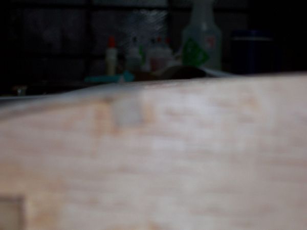

Ran into a discrepancy with the wing bolt plate . it is 3/4 of an inch to small . I`m going cut one out of 1/8 ply to fit the plans .
Not a big deal , but thought I`d mention that , in case some else runs into it.
