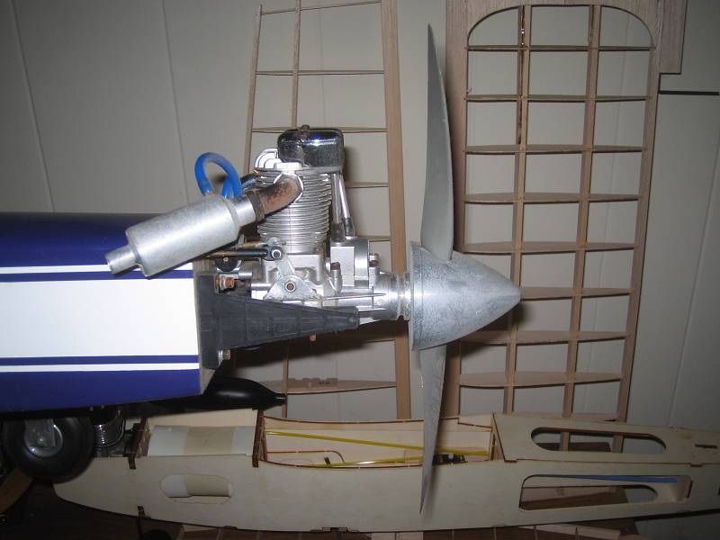

Deadeye, I have a Saito 91 in mine. I had plane since 1998 or 99. Never did fly it yet, too many other projects jumped in front.[:'(] I did just as you are thinking, move the servos to the back. I put 3 back there, 2 hitec 225BB and one Futaba 135SH on the rudder. The rudder is a pull-pull w/ a wheel instead of arms. The wheel is just right to protrude through the sides. I mounted the servo to the cover. Seems to work ok, at least on the ground. I would suggest using carbon push rods for your elevators, unless you use a smaller servo, then you can get them closer and shorten the linkage length.
I didn't do much up front. Chopped off the sides and wraped glass cloth over the firewall to about 2 inches back on the sides of the fuse. I also went around the top and bottom as well.
The landing gear block also received the same reinforcement.
I made some caorbon fiber wheel pants and a cowl, but I can't seem to find them. I also lost the wing tube. Does anyone know where I can find a replacement?
I plan to have this finished in about a month ( I have 4 other planes I'm working on as well, I think I have a little A.D.D. ) Can't wait though, All I here about this plane is how good it flies and owners are always saying, "I'm going to build another!"
DM

I would consider mounting the motor either on it's side or inverted. This will allow you to direct the exhaust somewhere other than the wing gap where it meets the fuse or the hatch cover. I found I did not need the hatch for the fuel tank. Mine slips out into the radio compartment just fine. This is a small plane so keep it light and it will reward you with a great flying model. I mixed flaps and ailerons and they are just about usless in my opinion.

bps.. You know I wanted to invert the motor, but a friend talked me out of it. He didn't like the thought of changing the thrust position. If I can't find my C/F cowl, I think I'm gonna change it to the way I wanted it in the first place! Besides, yel914's SSE looks soo good with that nose!
I forgot to mention to Deadeye.. The SSE balances WithOut any lead! Just move the batt. around to change fore or aft. and Lots of room, only one servo in there, throttle.

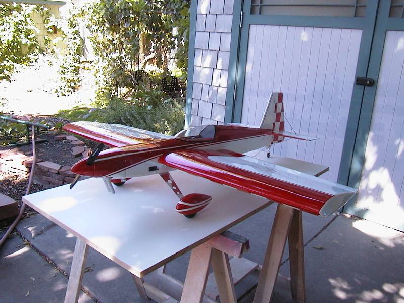

Thanks vintagflyer for the compliment. This plane is scale and is the racer version still housed in a museum. It flys like a ww1 airplane!

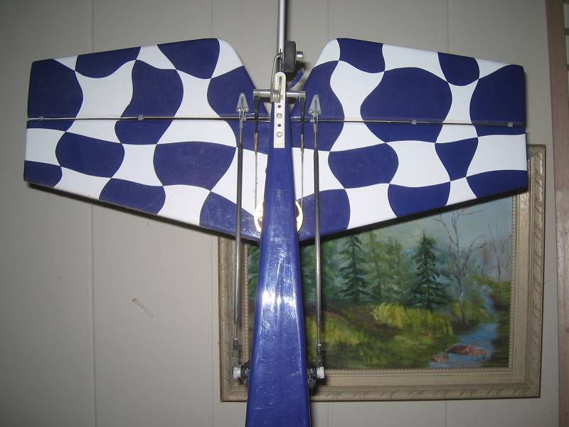

For what it's worth, here are my mods, I've heard lots about the airframe, and how it flies and although a 4 stroke is a fine engine most people agree that for this plane to do really well, a 2 stroke holds the key. Of course the decision is ultimately yours, I'm just passing along what I've found from other sources.
I also re-directed the antenna to come out the top of the fuse ahead of the rudder rather than drag on the ground and get caught in the tail wheel as the design calls for.
counter balances
more rudder surface area
pull-pull rudder
big landing gear with dubro tail wheel
ittty bitttty pilot
almost done

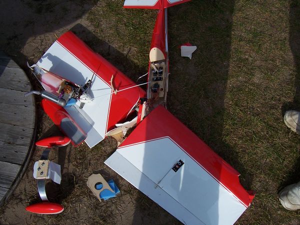

I have flown two of the SSE and loved both. I believe some of the modifications mentioned here will make the airplane too heavy. It is borderline heavy as is for a 46 engine that is not to say it won't fly well with a 61,91, 80,75. I personally liked the Tower 75 best on mine. With the larger engine you will get more air blown to rudder, elevator to give better knife edge etc. and naturally it flies faster and really comes alive. I added extra rudder/ elevator to my first sse but I prefered the second one with stock control surfaces and larger engines. You must be able to change an airplane with larger engines to compensate or lead will kill the airframe. (longer fuse in rear, shorten firewall, servos in tail)
I like the counter balanced controls but haven't tried them but if I build another I will give them a try.
Please go backup and look at the picture of Saito 91 above, its carb positioned at same level as the top of fuse, too high for consistent fuel flow. Mount motor on side and this puts carb in line with center of fuel tank and get consistent fuel flow.
