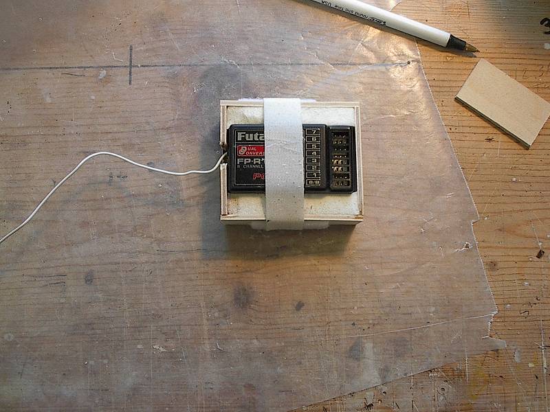

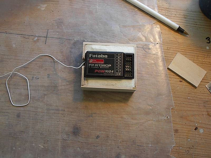

A few weeks ago the RX crash box was mentioned by me in A post and I was asked to show photos of one. Many years ago you could buy these as A kit from Tower and they worked out great and were very cheap. Today I make them for almost all the planes I build and they have helped save quite A few RXs for some race planes I have built for club members. Sometimes I add A screw down top to them too but this one is open and held in with velcro and sits in cut out foam with sides added then I epoxy it onto servo rails or stringers.
Good Idea. I have done similar with 2mm coroplast before. I also like to have a way to retain the servo wires so they don't rip the pins off the receiver in a hard crash.

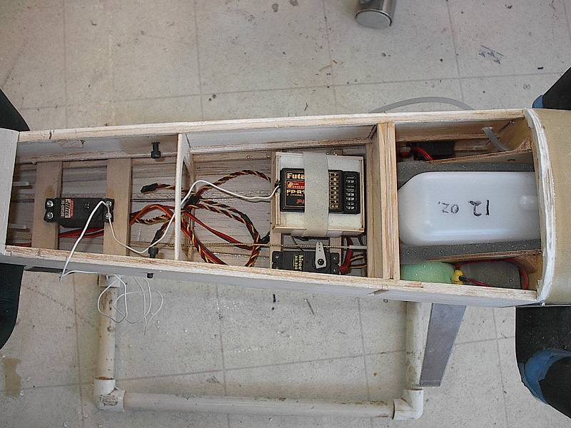

For servo wires I found some really cool clear plastic hook things that connect to the fuse sides with two sided tape, very strong tape too. They help clean up all the wire mess and the bay comes out very nice looking. This plane I'm working on now won't be ready for A couple more months at least, it's just in the process of getting everything installed and mounted at this point. Then I take it apart again and fill and sand then glass and paint. With my own planes I have no time frame so I don't ever get in too big of A rush, it could be done in A week or two if I was just going to cover it.

These work great and I have one question. Don't you want the majority of the foam to be placed fore and aft of the receiver to help absorb impact shock?
Austin,
I had a couple of crashes that toasted the receivers. You could shake the case and hear little parts inside rattling. <g> In a slow sport plane I would agree with you. A fast big warbird can really mess up the equipment inside. I've never done a receiver box. But I would call that a good idea. <g>

The only reason for this post was because I used the words Crash Box in A build thread and got hit with PMs asking what the heck it was. It's just one of those things you either do or don't do. If I have the room for one then I do, if not I don't worry about it and do things differently.
Found out Tower still sells them and they make A good one for little money.
This wasn't any debate. If you like the idea go for it, if not forget it. This is what one looks like.

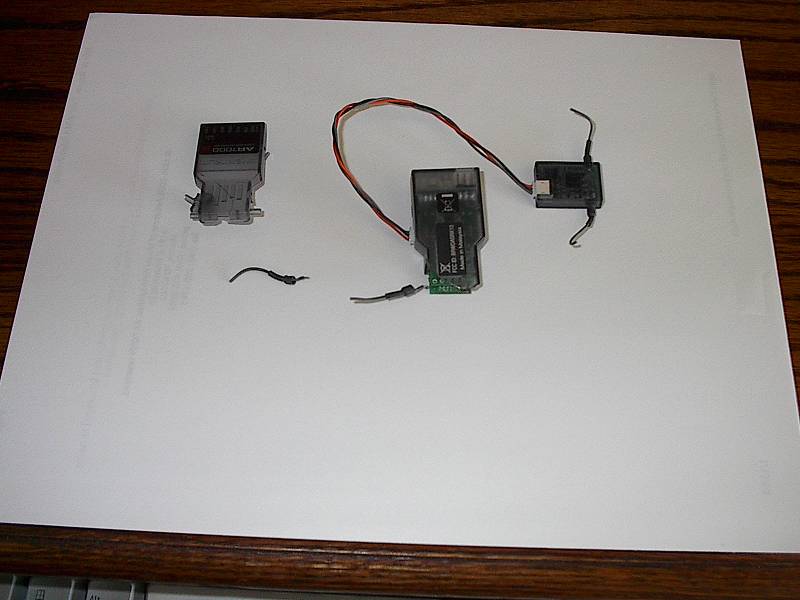

Odd that this should have happened after I posted this but my 12 year old student had A glitch of some kind?? Not A pilot error, I think it was A bad switch but we will never know for sure.
No crash box but the RX had A good foam wrap. The battery was several inches behind the servos and RX. The plane hit on it's nose from A couple hundred feet and the battery knocked everything out in front of it. Would A crash box have saved the RX, who knows but it couldn't have hurt.
