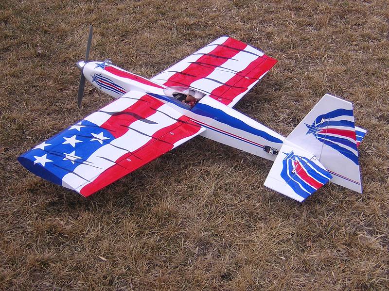

Old 07-20-2008 | 10:35 AM
Deadeye's Avatar
Posts: 4,516
From: Dutton, MT
Default RE: SIG Somethin Extra wing attachment
I use a small square of 1/4 aircraft ply on the inside, tapped for 1/4 nylon bolt. I also replaced the small dowel anti-rotation pin with carbon fiber arrow shaft. Mine's got a Saito 82 on it.

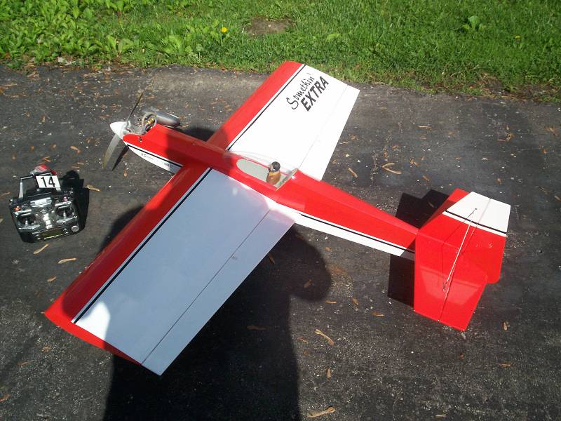

Old 07-20-2008 | 07:37 PM
skyraider71's Avatar
Joined: May 2008
Posts: 837
From: mount washington, KY
I just use two rubber bands on mine, no problems, and I fly the crap out of mine!
Stick with 2-stroke power, I have an O.S. AX .46 on mine. It hovers all day on a
11x6 APC! That plane will be lighter than you think, and there isn't much room for
bigger props. It's a great kit, and an AWESOME airplane![sm=shades_smile.gif]
