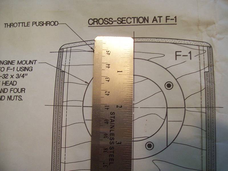

I believe the firewall on this kit is 4.5 wide x 5.5 high, the former per se. If this is incorrect, please advise?
My question is, what is the vertical distance from the top of the firewall to the centerline of the prop shaft (thrust line)?
Thanks in advance if you can assist.
DR

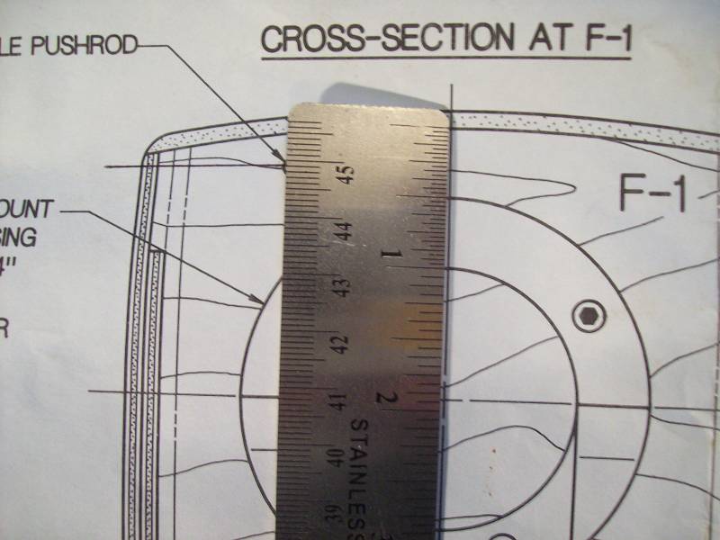

Default RE: Four Star 120 Question
Hear is a couple of Pic. Will this help? I got about 2 1/16" to the top of the the plane.

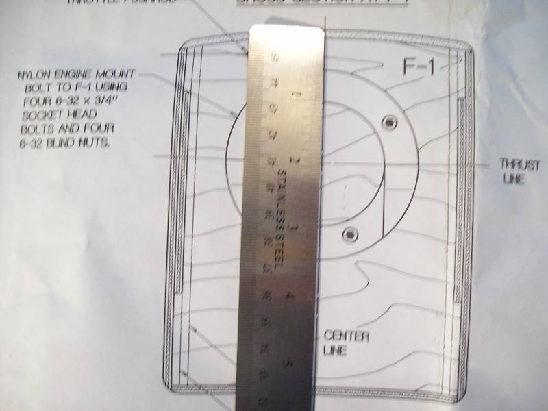

Old 02-12-2008 | 03:35 PM
Joined: Jan 2006
Posts: 113
From: oneida, NY
Couple more from the top of the ply.

flyinbr,
Thanks a million. This is a terrific help to me.

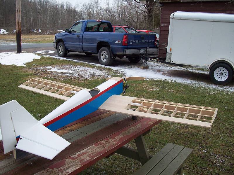

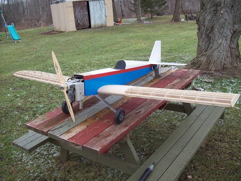

Old 02-12-2008 | 08:15 PM
Joined: Jan 2006
Posts: 113
From: oneida, NY
Got a couple of pic. on mine this is how far I am on it.
