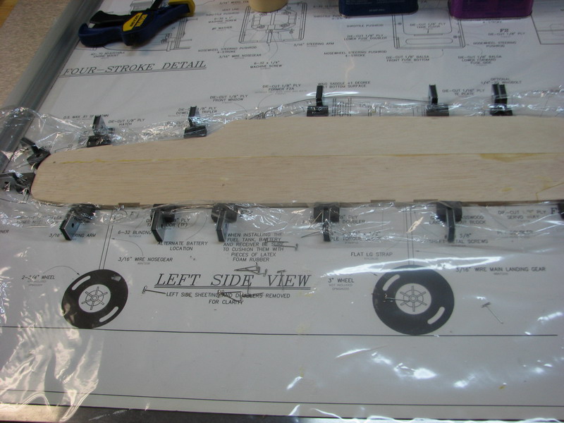

WOW! This building with magnets is even better than I hoped. I had laid up the fin and stab on it and used the magnets as clamps until the Titebond set up. Here is the Fuselage sides undergoing the same treatment. I had full solvent cans placed for weight until drying. They are removed in the picture.
I have to admit, there is a lot more waiting time for the Titebond to cure, but it does beat having fumes in the eyes, and it is sure easier to sand!!

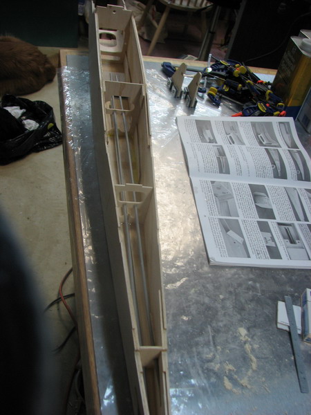

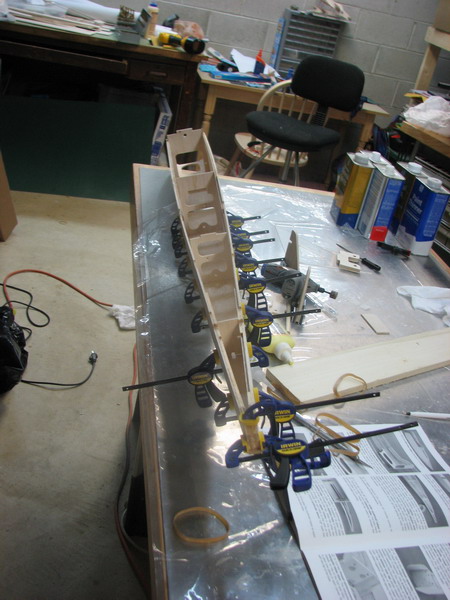

Here is more that I did tonight. The first pic shows the Fuse sides with the doublers finished, the formers, the wing bolt plate clamped and curing, and the firewall clamped and curing. The fuse sides ended up very flat. The doublers were installed with medium CA.
The second pic shows the essentially finished formers and firewall.
I forgot to take a pick of the install of the formers. Drat! I pressed too hard and former #3 shattered on me.[sm=sad_smile.gif] 5 pieces, but it glued back together well. [sm=shades_smile.gif]
Pic three is gluing on the bottom rear sheeting. It was done in Great planes wood glue, and hence the clamps. The front bottom sheeting was done with CA.
Pic four, five and six is the finished bottom sheeting and assembly. This shows the formers in place.
Pic seven is of the pushrod tube and antennae tube installed.
Pic eight is the clamping of the top sheeting. That's where I am right now. Waiting for glue to dry....
There's gonna be a lot of sanding!!

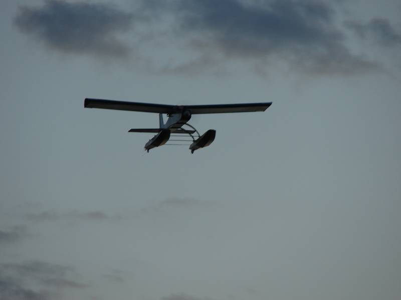

Doing a good job Housedad, and even more kudos for getting your daughter involved. this can be a great family hobby.
Five years ago I got back into RC after a 15 year absence. I built a PT-60 and still fly it quite often. I use it to teach other people to fly, and also fly it year round off of skiis and floats. A good flyer that will be around for years. It has taken a bit of abuse thru the years, but is still a great airplane. I will build another if I re-kit it.
