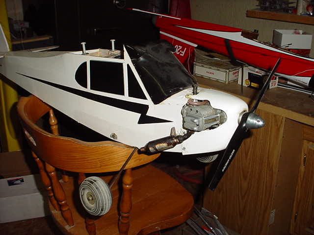

I like the Carl Goldberg kit. Very good wood & built to last. I built the long wing and I power it with a Magnum .61 4-stroke. Flies great
