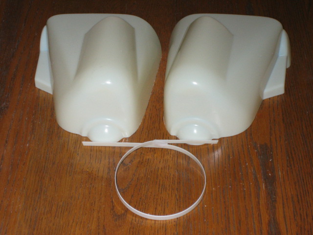

I am using a SIG Smith Miniplane 2 piece cowl on a current project. I have no experience with assembling cowls. Can someone give me a quick overview of the official SIG assembly approach? Yes, I have done some research on best practices when assembling ABS cowls, just need to know how SIG thinks it should be done.

I had to build one recently and I used CA glue. Also used pieces of the molding to install on the inside surface of the seams to reinforce them. The CA seemed to almost melt the plastic a little which yielded a very solid bond. Smoothed over edges with microballoons. Had to do some wet sanding to get a good paint finish but the finished result looks nice I think.

I use some tape to hold the cowl in the correct alignment, then add 4 or 5 SMALL DROPS of THIN CA to the inside of the cowl. After that has dried I take some 1" wide strips of 2 oz fiberglass cloth, lay them over the seams and glue them in position with thin CA. I also CA a strip of fiberglass to the inside of the outer edge as re-enforcement for the screw holes.
A tip for you..... Take the scrap pieces of the ABS cowl and cut them into small pieces (about 1/4" square). Put the pieces in a small jar with a SMALL AMOUNT of acetone and let them disolve into a thick "slurry"/paste. Use the slurry to fill the seam on the outside of the cowl, Your fill will be colored matched to the cowl, and if you work carefully, there will be almost no sanding involved

For Sig's plastic parts i have always used modeling plastic cement. This will hold pretty well and then i will reinforce the joint on the inside with some CA. I have used the plastic cement as filler before, but i discovered that epoxy with a bunch of micro balloons (or baby powder in my case) does a dang good job.
Then if you do some good prep work before painting, you will never see the joint and it will look as good as any fiberglass cowl.

Bob Nelson of SIG Mfg responded:
Trim the edges to get the width that you need. Glue the strip to the inside of the seam on one side of the cowl allowing about 1/2 of the strip to protrude out. This creates a ledge to support the other half during and after the joining process. You can use acetone to chemically weld these joints or medium CA. When the strip is glued in and the glue has cured, tape the other half over this flange and finish the glue joint from the inside. Since CA cures into acrylic plastic, it can be used as a filler to blend the outside seam. When satisfied with the joining, sand the shine of the plastic, wash the outside thoroughly, prime and paint.
