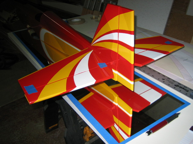

Pic 1: finished bottom - the base is red with white and yellow trim - no perforations. Trim applied with a very low heat, socked iron moving, very very slowly from one end to the other. Same technique used for both wing and tail feathers. No bubbles.

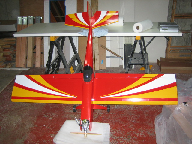

Pic 2: finished top - base is red with white and yellow trim - sharpened T-pin used to perforate under all trim. Trim pieces were cut and laid out as stencil and outlined with sharpie fine point as boundary for perforations. Trim applied with a very low heat, socked iron moving very very very slow ly from trim points to broad ends. No bubbles.

Pic 4: finished tail feathers - base red yedda yedda yedda - no perforations. Trim applied with a very low heat, socked iron moving, very very slowly from one end to the other. Same technique used for both wing and tail feathers. No bubbles.

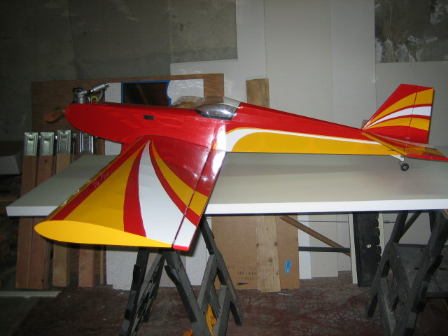

Pic 5: finished side - yellow base laid down, then red base overlapping yellow, then white trim applied - no perforations. Same technique. No bubbles.

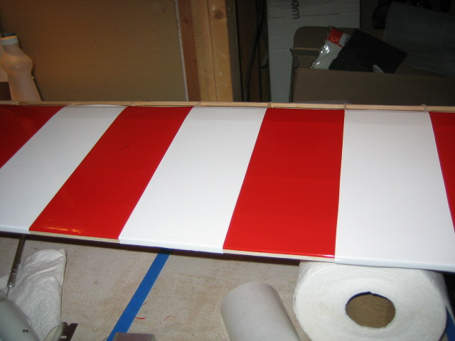

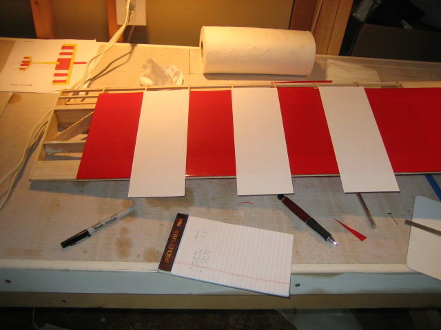

Pic 6 thru pic 8: application of white trim over red
I had to remove-replace several pieces because I moved the iron too fast resulting in captured bubbles irrespective of perforations used / not used. I can't over emphasize that the iron needs to be moved ever so slowly.
My favorite LHS owner (one of our best builders) looked hard and long for bubbles - he commented that this is one of the most "bubble-free" coverings that he had ever seen. The above technique must work.
