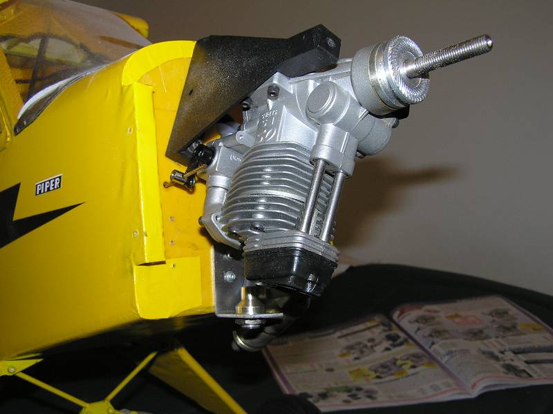

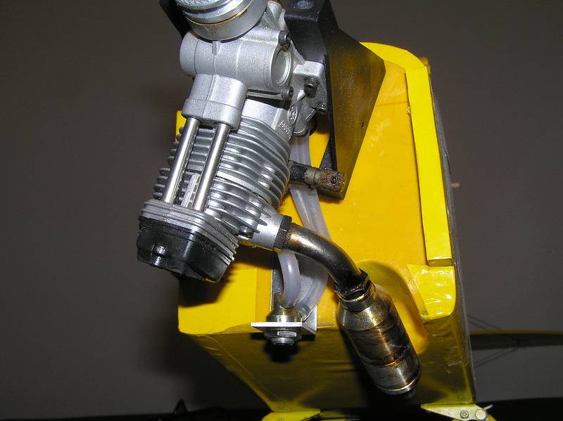

Old 03-12-2008 | 10:17 PM
tailskid's Avatar
My Feedback: (34)
Joined: Nov 2001
Posts: 9,554
Received 7 Likes on 7 Posts
From: Mobile, AL
Default RE: Sig 1/5 Cub question
Here is my set up .... same engine...
ID:	902059   Click image for larger version
