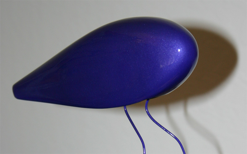

I don't know what you are painting or how much you want to spend but I have had excellent results with the PPG Paint sold through Radio South RC. The metallic plum was an exact match to the covering.
