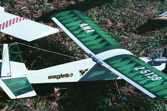

Don't have an Eagle or an Eagle II, but I do have an Eaglet, about 15 years old with a Magnum .25 engine.
Fine airplane.
Bill.

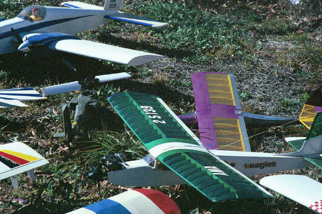

Default Eaglet again
Sorry, wasn't the picture I wanted. Try this.
Bill.
PS: You can get an idea of its age by the WATER TRANSFER decals having yellowed. wr.
