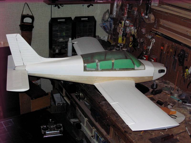

Hi Everyone,
I assembled my Arrow yesterday and weighed it. In the state shown it weighs 11 pounds 9 ounces. With the rest of the covering and require paint it should still be less that 13 pounds. The OS 91 should be able to fly it in a scale manner. Shown also is the full scale bird I am copying.
