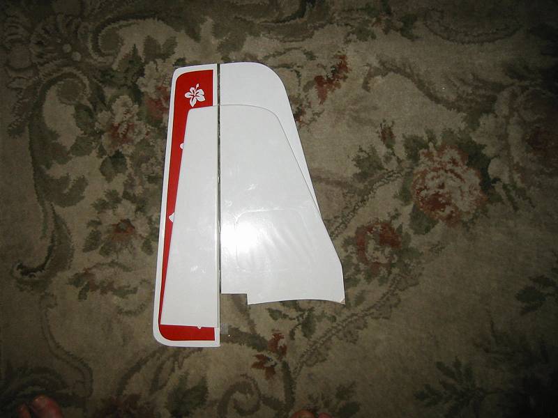

Old 07-21-2008 | 11:30 PM
OzMo's Avatar
Posts: 2,694
From: OZark, MO
Default RE: Senior Telemaster suggestions
Hey Telemaster flyers,
I ran accross a Hobby Lobby Telemaster 60 ARC that has never been covered. But the wings were joined so I got it reasonable do to being able to pick it up (no shipping an 8 foot wing).
Anyway I want to set it up for glider towing. Ben Diss release and OS 91 FX for power. How much increase in rudder? I read it needs some but I would assume even more for glider towing? Should I add to the ailerons? I will be using a futaba 7CAP radio so I can mix and set up diferential, etc.
OzMo
Old 07-24-2008 | 07:44 PM
Broken Wings's Avatar
My Feedback: (20)
Posts: 2,090
Received 5 Likes on 4 Posts
From: Cocoa, FL
I did the same thing. Mine flys great. Here is the stock vert stab laid over the larger one.
