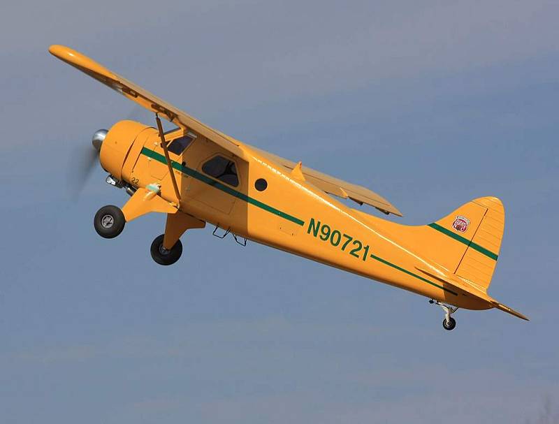

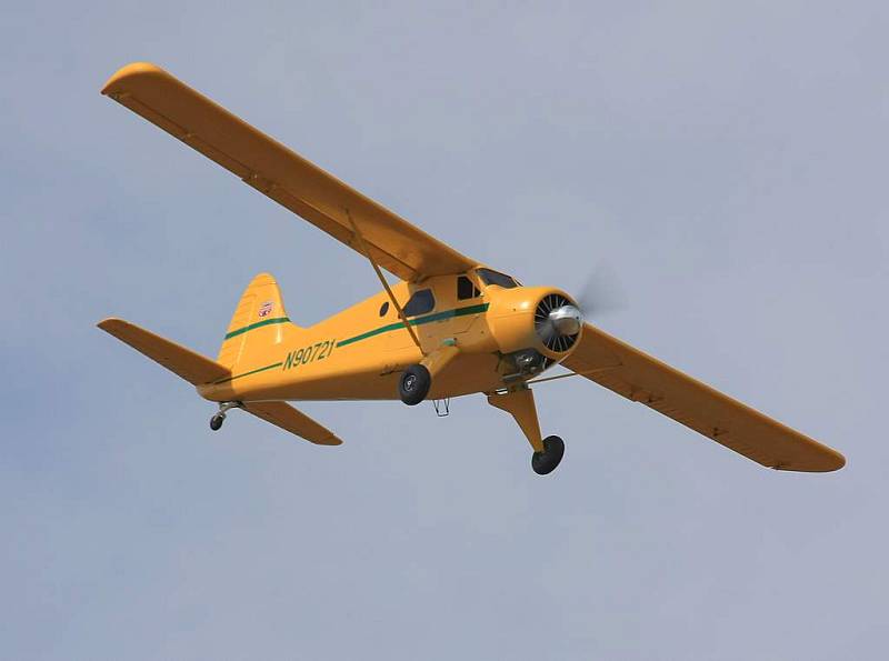

First posted in the "Seaplanes" section, here's my 18% DHC-2 Beaver from an MRAeroDesign kit.
103" wingspan, 24 pounds, Saito FG36 gas four cycle engine, Spektrum DX7 radio, JR digital servos.
Covered in 0.75 oz. glass cloth using water base polyurethane, Warbird Colors paint, graphics from Kirbys Kustom.
Full scale plane is owned and operated by the NC Forest Service in Kinston, NC

Looks great!! How's the new Saito on power?

The Saito FG36 pulls this plane up at about a 45 degree angle no problem.
It does, however, need an electric starter to get it going the first time of the day.
After that, there's enough fuel in the carb to hand start after 2 or 3 flips
15 minute flights use maybe 6 to 7 ounces of gas.
20-8 APC turns at 7800 RPM on the ground
