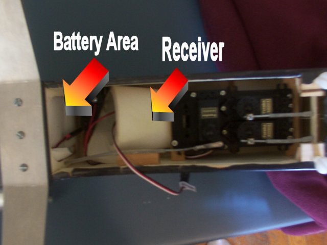

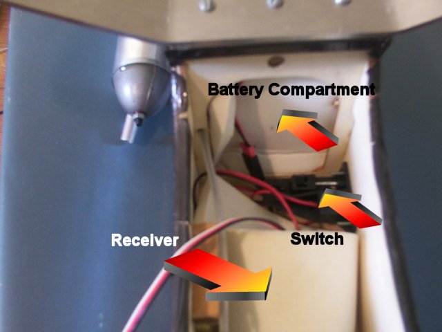

thanks for all the input on this kit, im looking at the radio installation and if anyone has any pics on their setup could you e-mail me or post them, im going to use the black servo tray that comes with the radio for my three servos. but the way they show the installation they use the round servo horns, im going to use the four arm and of course cut off the ones im not going to use,but they will not fit the way they are pictured. to make sense about it the pushrods in the picture come through the center fuse together, im going to need to make it where the elevator and rudder pushrod come out one close the the left side and the other close to the right if this makes any sense thanks everyone for the help
Old 05-11-2003 | 04:55 PM
Posts: 331
From: Waynesboro, PA
Default sig 4*40
armyrcer,
give me 10 minutes and will post a few pics of my servo setup
Old 05-11-2003 | 05:12 PM
Posts: 331
Default Pic 1
Here as one pic with all the electrical components.

Old 05-11-2003 | 05:13 PM
Posts: 331
Default Pic 2
Here is a pic of just the battery receiver area's
HOPE these help and what you are looking for

Old 05-11-2003 | 05:22 PM
My Feedback: (17)
Posts: 471
From: front royal, VA
Default sig 4*40
thanks alot that helped a bunch how much luck do you have with those round servo horns for elevator and rudder, i have never used them but after your pics i just might try it out that way. i looked at your website with your flight box i have just picked up one of those at lowes last night so between the glue drying i work on the flight box, so the post on it today just about that setup on the flight box from billy i think, but thanks again for all your help
