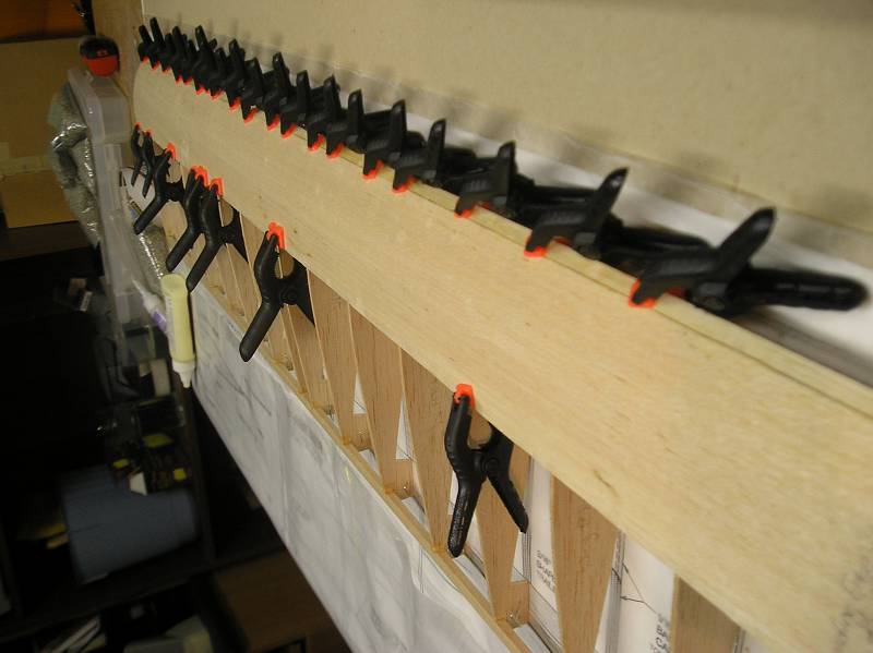

hey everyone i am about to begin my FIRST kit and am a little confused on how the sheeting process is done. Forgive me for sounding completely illiterate to kit building and i figured id get the help here as i am a little embarassed to ask at our club. When its time to sheet the wings and fuse, how does the balsa become so curvy? do most kits come with sheeting pre bent? or is that for the modeler to do. for example i will be buying the top flite p47 gold edition kit and was looking at the manual pictures. i will be doing the razorback version and in the rear where the tail, vert stab, and fuse all meet it looks VERY tight, crisp, and well- hard to do! what im saying i guess is how do you sheet balsa? how is it "bent" into shape and how is sheeting accurately glued or secured in place? im thinking the sheeting process is going to be the hardest part of the build. Sorry for the stupid questions im not what you would call a woodworker- i can build one hell of a race engine tho! im more of a motor head than craftsman, but with a little help im sure i can tackle this. building ARF's is fun to a point......once you build *ahem* ASSEMBLE 4 or 5 arfs its not as rewarding. im ready for the next step but need all of your expert advice. Everybody here really knows their stuff and i love this place for that reason...... thanks in advance!

also, on most kit building they direct you to pin pieces to the plans. how do you pin pieces down such as the elevator ribs? to the plans if they stand upright? do you pin directly thru the balsa? seems silly i know but given balsas brittle anyway is that what you do? (as everyone reads this you put your face in your hands and shake your head lol) am i asking these questions in the right place or does this topic belong in the beginners section? sorry for wasting your time!

Any good set of instructions will show you a picture of the parts as it instructs you to make us them in the build process. Also, the plans themselves should be clearly labeled and by virtue of multiple views, you should be able to determine the names of the various parts, as well as their proper placement.

The wetting of the sheeting will help the wood to bend. A cap full of amonia added to the water will allow it to bend more easily [)] .

i heard of people using windex? to wet their wings in pure form. wasnt sure whats practiced and/or whats acceptable. Thank you kindly for all the generous and wise feedback. the airfield models site just opened up a whole new can of worms for me but in a good way- ill be on that for the next few hours. What are fairings and fillets? the site has a superb glossary but i cannot visualize what they are. As far as the p47 goes- the other reason im pretty sure i can achieve it is because i have heard great things about it with the selig airfoils and the stability of this aircraft than most warbirds. im currently assembling my 3rd tail dragger- while it is very different than trikes, im used to it by now, and from flying my Sundowner F1 it has a much higher wing loading and VERY hot approach and landing speed- ive been flying and assembling planes of all types- trainer, pattern, sport, racing- now im really stoked about my first warbird- and i want to kit it, once again thanks for your input- it really helps

The "orginal" windex is amonia based. Water with a cap of amonia as suggested above works just as well and maybe better. No staining of the wood blue either.
Tips from mistakes I've made.
Protect your plans. A sheet of cheap painters tarp (thin plastic sheeting) works well. One tarp will keep you in business for a number of builds. After you are finished, keep your plans in case you need to fab some replacement parts.
Pins are not to be pushed through the edge of the sheeting into a rib or former. It usually splits both. Pins have a place in building, IE locating pars on the plan and holding parts to the build board. Just don't push them through the wood. When removing the pins, give them a half turn to break the glue before pulling. This will prevent damage to the wood. When sheeting, say the LE of a wing, make sure the pins below the sheeting are removed. Getting the wing off the building board is a real pain other wise.
Use the right adheasive. CA is wonderful in very small amounts. Use a capilary tube and don't squeeze the bottle. Just a dab will do ya. A little more caused greif. Don't use CA where sanding will be required as the stuff hardens like steel and is al but impossible to sand. The balsa around the CA will be sanded away leaving a ridge of CA. Use white glue or the yellow carpenters glue for this.

I've done a lot off sheeting in my many years of kit/scratch building. Here's what works well for me.
Apply the water/ammonia mix to the outside of the sheet only. As the mixture soaks into the wood, the wood will bend naturally on it's own. This elliminates a lot of the stress put on the piece when you do the final bending. Don't rush. I usually let the sheet dry in the warped configuration, and then re-wet for the final installation. If you rush, you might crack the wood sheeting. I only use yellow carpenter's glue. It soaks into the wood and allows time for positioning. Most of the glue is water and when it evaporates, the weight is almost nothing.
Clamping is a problem with straight pins unless you use a "plate" applied on top of the sheeting. I use a thin, small piece of balsa or card stock like a business card. This plate will allow the pressure from the pin to be distributed over an area much larger that the pin shaft and ensure a good bond to the sub structure.
I cut paper templates for the critical ares such as the tail cone, wing tip, etc. Then transfer the pattern to the sheet and cut before you wet it.

Cory: A quick and inxpensive (relatively) building table can be fabricated from a hollow core door supported by a frame of 2x3's.
On top of this you might put some large ceiling tiles. If you go to an outlet store you can pick up "seconds". This is a door with a blemish or scratch that detracts from the finished quality. These imperfections will not impact it's use as a building table. I bought one with a deep scratch for $5. I positioned the scratch on the underside.

I bought about a dozen of these to hold parts upright over the plans:
http://www3.towerhobbies.com/cgi-bin...?&I=LXM406&P=0
The slots are cut to fit 1/16, 3/32, and 1/8 parts which covers the most common wing ribs. I'm sure there are some really big kits with thicker ribs but they are totally out of my league.
