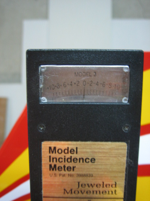

Krayzc - I have a Robart incidence meter. Used with no instructions. I'll check around for some instructions.
Basic question: I'm guessing that an incidence meter provides me a measurement, in degrees, between two lines. From your post I gather that it would be helpful to know that measurement between the wing chord and some line, the horizontal stab and some line and the engine thrust line and some line. What is the "some line" that I'm comparing the wing chord, stab chord and thrust line with? I'm looking at the plans as I'm typing this reply. They recommend a 2 degree down thrust (or -2 degree), a +1/2 degree incidence angle for the wing and no angle for the stab. There is no reference line on the plans to be used to establish any of the angles. Can ya help me how to establish the reference line?

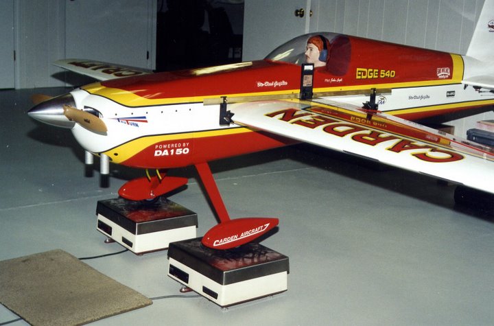

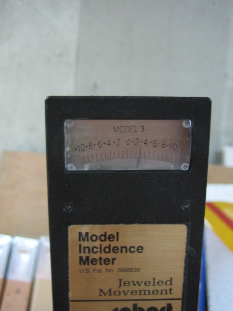

According to local talent - the horizontal stab can be used as the datum line for a 4Star60. I will confirm that with SIG techs tomorrow morning (they've already gone home [>:])
Kit wing incidence specification is +1/2 degree
Actual wing incidence is -1/2 degree
Differential: off 1 degree - can be shimmed at the rear mounting block
Tough to get accurate reading because aileron spans entire trailing edge of the wing from tip to fuse.
Kit engine thrust angle specification is -2 degrees
Actual engine thrust angle is nearly -3
Differential: off 1 degree - can be shimmed w/ washers at the bottom of the mount
Comments?
Pic 1 is horizontal stab
Pic 2 is wing
Pic 3 is engine mount
Comments?
Pic 2 is wing

A 13x8 prop will rev to 7200 rpm - with absolutely NO pull! A 13x5 will rev to 10,500 freely - plenty of pull on take off. Apparently most of my take off problems are related to poor prop selection.
The motor mount has been shimmed with 2 washers at the bottom - kicking the thrust angle back up to -2 degrees.
The wing was shimmed to adjust it to +1/2 degree from - 1/2 degree.
The static setting of the ailerons resulted in them being "down" resulting in an unintended "flaperon" alignment - nosing the plane over with neutral aileron settings.
What I learned:
Before covering - determine adherence to manufacturer's incidence guidelines and adjust as necessary.
Before flying - talk to locals about prop selection (we're well over 5000 feet where normal hobby standards just don't cut it)
Make sure that static control surface adjustment is close.
