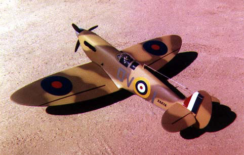

In 1979 I set out to see just how good I could get a Sure Flight Spitfire kit to look. This was also an all-foam model. At the time, there was a company that made fuel proof, flat, scale colors for painting foam. The name of the company escapes me now. I also put the Robart strut covers on it, and fake strut doors on the gear legs. Found a "blank" veco spinner so I could cut it for a 3-blade prop (the spinner was also highly polished). Even made a non-scale cockpit complete with pilot. At the time, everyone in my club thought it looked really good, "for a foamie". The attached photo is of that finished model.
While it looked good, that finish didn't do anything to "toughen up" the foam. Practically everytime you even looked at the plane, you came away with more dents, dings and hangar rash. It seems, in this day and age, someone would have come up with a product that you could apply to foam that would toughen it up, and would be fuel proof. I've got a Sure Flight Waco Cabin biplane (also foam) that I've delayed building just for this reason.
Maybe the lightest fiberglass cloth would be the way to go. In my nearly 50 years of modeling, I've never fiberglassed anything but would like to learn those skills. I always thought fiberglassing a small model would add too much weight, but I'm hearing others say if you use the light weight cloth, it's not much different than say, a Koverall finish.
One more thing about that Sure Flight Spitfire - it was a real pig when it came to flying. It loved to snap roll if you slowed it down to much (like when trying to land).

I had the older spit also. I had a O.S. FP .40 in it. I covered it with Hobby Shack Cheap cote film covering and then spray painted the camo on. It flew really good.
Yes the glassing would toughen up the skin. If you go to the sure flight web site they talk about fininishing them with glass, latex paint.

I'm sorta surprised to hear someone say their Spit flew so well. I had a ST .40 in mine and, even though it balanced right on the money, it was a squirrelly son-of-a-gun. Always wondered if it was a design flaw because all the parts were molded from foam so the incidences, etc. were already factory set. Could be they made changes in later production runs. I think the one I had was one of the first ones (as I recall, the Spit kit had just come out). Sure Flight had such a good reputation for ARF foam kits, I thought this one would be great, too. Their Piper Cub and Cessna were just great. The Spit was too much of a handfull and I wound up trading it to someone that liked things dicey when they flew - after I repaired the top of the vertical stab, which was ground off when it snap rolled onto the runway on it's first landing! As I recall, it made one snap roll on final about 30 feet high, but recovered. Then it snapped again into the runway from about 10 feet! You just could not slow it down at all. Too much for me!

I know that mine flew WAY better then the other two in the club. I had the C of G in the forward location suggested and it was lighter then the others. If you slowed it down in a turn, you had better have clean shorts handy because it would do the most awesome snap spins around. I read some where way back when the the full scale spit would drop a wing in the turn if you were not ready for it. I just landed a litle hotter then my other sport planes and did not have any real problems flying it. It was a handfull on the ground at first due to it being my second tail dragger and first war bird.
