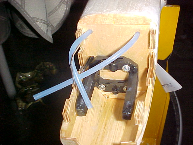

Old 05-12-2003 | 09:21 PM
IFR
Posts: 155
From: Wabash, IN,
Default Engine for Great Planes P-51 kit?
I think you will find that you will need the universal engine mount that is two separate legs which allows you to bring the engine all the way back to the firewall. My GP's P-51 has an OS 70 and this is the only way I could get the engine to fit. Since you mount the engine to complete the shaping of the plane's nose I imagine you could do some fabrication to extend the nose to allow for the added length created by the engine mount, but at $5.00 for a new mount I would save the work and try to keep the scale appearance. Just plug some round wooden dowel material into the holes in the firewall and drop some CA on them and your firewall will be as strong as new.

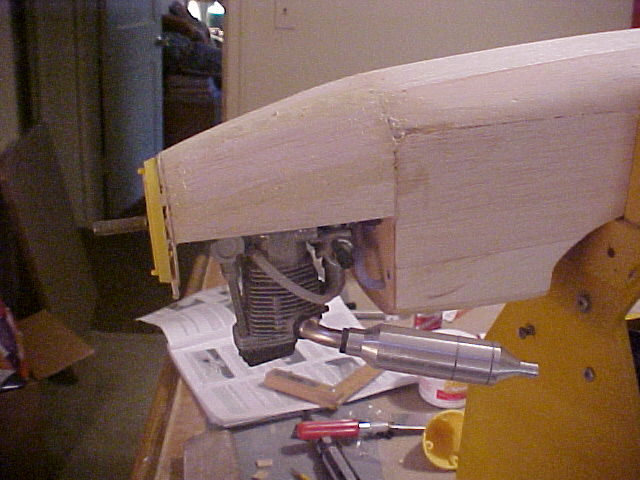

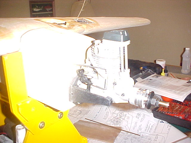

Old 05-13-2003 | 11:38 PM
Posts: 45
From: Tulsa, OK,
I'll post a few pic's during construction of my OS 70 Surpass on the same plane. It worked fine.

Old 05-14-2003 | 01:42 PM
Joined: Dec 2002
Posts: 321
From: Palmyra, NJ
Hey, thanks for all of your responses, guys!
Saturn V, I have a few questions.
First, did you need to modify the mount at all to slide the engine as far back as possible?
Secondly, did the length of your P-51 nose come out similar to what was shown on the plans?
Third, from one of your pics, it looks like the nose of your plane points down a bit. Is this because you inverted your engine, or was your pic taken from a weird angle?
Thanks a lot!
-Dan

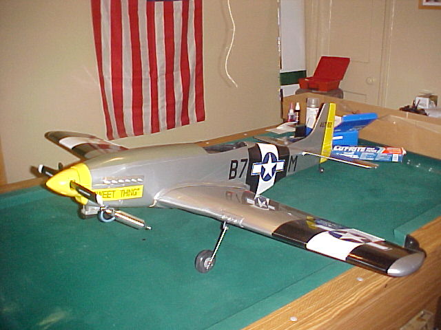

Old 05-14-2003 | 11:40 PM
Posts: 45
From: Tulsa, OK,
1.) No, it was an adjustable mount.
2.) Yes the length was close, the support beams needs to be trimmed to the correct length. There's a section in the manual about mount the back of the spinner with a spacer, etc.
3.) I hope it's just a weird angle, the motor mount is square with the firewall. I may not have trimmed the supports perfectly square. Here's a finished pic.
Old 05-15-2003 | 06:22 PM
IFR
Posts: 155
From: Wabash, IN,
For what it is worth, the Universal Motor Mount is made by Carl Goldberg Models. I did have to shorten one leg on the mount to allow for the carb linkage travel. With this mount you can bring your motor all the way back to the firewall and match the motor mounting laid out on the plans.
