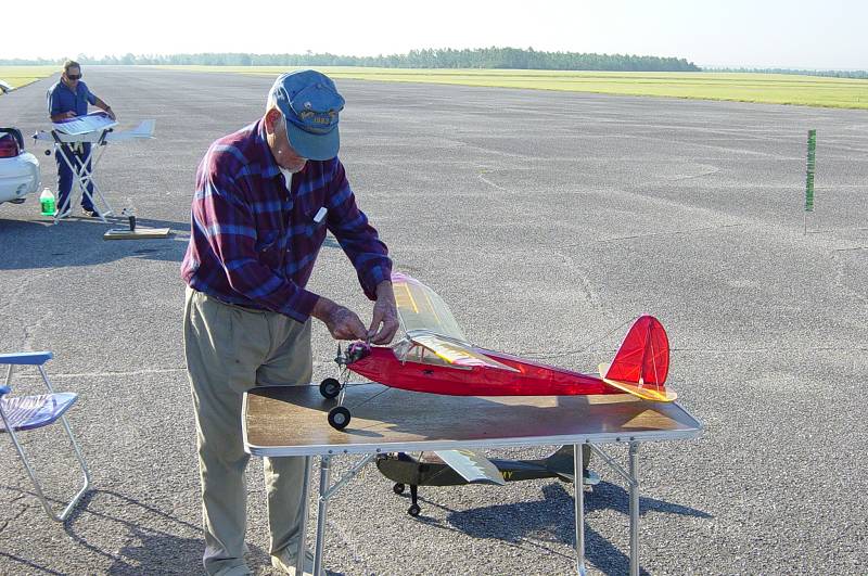

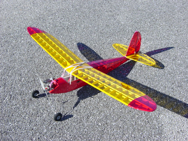

As I recall, this came up several years ago and it was found that the fumes from CA when heated with a soldering iron ARE toxic. I would recommend not doing it.
Nice little plane. We have one my buddy built that we take out occasionally and sit in a chair and soar around.

Thanks for the info and the photos. I noticed a guy wire extending from the rudder to the stabilizer. These are not shown on the plans I have. I was wondering if they are necessary and what they are made fo. I am always looking for new and helpful ideas.

The tail looked a little flimsy to me so I had Flaps (the builder) add the guy wires. They are made from the lightest weight weed eater line, weigh next to nothing and work fine. We drilled 1/16" holes, ran the line around the tail and fuselage bottom and used medium CA to hold it in place.
