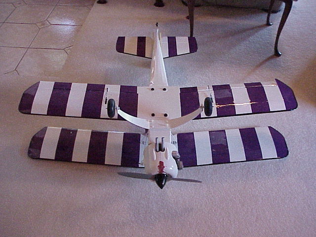

I'm perty much limited to straight lines also. Some turn out OK. The first two are of a GP Super Aeromaster kit I built last year, but haven't got the nerve to maiden it yet. The third is my Pink Stick with stock Laniar Explorer 40 wings. The botom of the Super Aeromaster is typical of any plane I build now.
The bottom vs top pattern difference is the most important thing as far as max visibility is concerned. The colors don't matter much as long as they are easy to distinguish from each other. Patterns whith a flow from the fuse to the wing tip on the top and nose to tail on the bottom seem to be best.

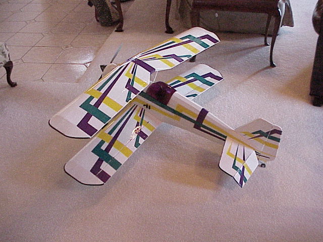

I wish I could claim that it was my idea, but I saw another one, different colors posted here when I was looking for inspriation on the covering.
The white base is Ultrakote. Love that stuff for the comple curves.
The color is all monokote applied using windex with amonia. It worked well on the UltraKote. I guess it took me about a week of work on the trim. It's what I would call a 20 footer. If you get closer, you can start to see my mistakes.
The layout was fun, but once I figured it out, it went on OK. I got some large poster board and drew the pattern on it. I then layed out the color and poked a straight pin through the poster board into the covering. I then used a long straight edge and cut straght lines between the pin *****s. I did one side, then on the other I put the color upside down on the board and poked the pin through again. Things didn't align the way I had hopped, but applying a little Kentucky Windage, it worked out OK. I didn't realize it until my son commented on the Celtic pattern. I guess it is. On the rudder, I ran one color over the second vs piecing them together. That was my first surface, and I only did it with the yellow over teal. All of the rest are butted together.
Some day, I'm going to figure out how to do curves. For now, I trapped in straight lines.
