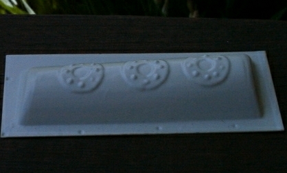

I wasn't working on wheel wells, but I have made up some m.g.s. I want to let Wing Mfg. have them so they can make plugs and duplicate. Whatever they do, I have some sets made up which will be available around June 1. Here is a pic of ones which I installed on my (Top Flite) Corsair. It is a retrofit, meaning I installed and painted them AFTER the plane was already completed (and flown).
I will keep you posted, AND post a pic of what they look like right out of the mold (unpainted, untrimmed).

Here is a pic of my (Mattel) vaccu-formed Corsair 1/8 scale machine gun ports. I have just lent them to Wing Mfg so they can make mold plugs, for the purpose of possible mass production. When they are done with them, I will sell a few of these sets, probably around June 1.
By the way, my supply of plastic plates for my Mattel Vaccu Form is getting very small, anyone out there have some?

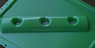

And here is a pic of a D&B 1/8 scale Corsair machine gun port (from the long ago discontinued kit), which I chose NOT to copy as I feel my design is better.

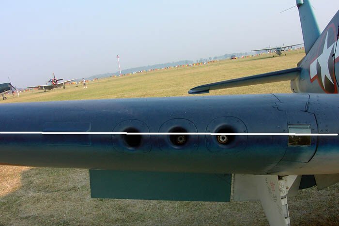

Hey Corsairjock, you chose not to lower them toward the tip as the full scale? Each port is a little different. Yea those D&B ones suck!
I drew a white line on the leading edge to help the eye!

OK, i did a sloppy job of installing them. As I said, it was a retrofit. Best way to install them is BEFORE finishing/ MonoKoting/ 'glass and painting (your choice). Heck, this is supposed to be my every day/ Sport Corsair, I had intened to finish up a red box one by this summer which will be far more detailed and accurate.

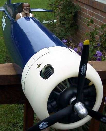

Here is frontal of cowl. Note that flaps are slightly open, EXCEPT on top where they do not open. Sawtoothed flap separation lines have been partially filled with black paint, which will make them stand out more when UlraKot Corsair Blue is applied (covering is UltraKote Corsair Blue).
Up close, I'm sure there are many other Corsairs out there that will be judged better. But like I said, I beleive mine will be judged better in the air.
BTW, engine is YS .63. I had a YS .53 in previous (gold Edit) for awhile, it flew it well but ran hot when on the ground. Improved cooling on this one (remember the rouded fuselage/ cowl flap area?) should make this one run better.

Your plane looks great but the deck railing could use a new coat of stain
Did you use a saw or Xacto to cut the cowl flaps?
Pete

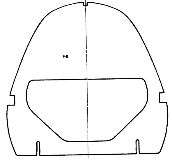

The one area that really bothers me about the TF kits other than the wing incidence is the top of the nose. The former in front of the cockpit is F-5 on the TF and F-6 on the Royal. If you look at the factory drawings, you will see that the top of the nose is not round like the front. It instead bulges up to meet the canopy. I think TF copied the Ziroli or Ziroli copied the early Red Box Corsair, because they are both the same in this area and in many others. But trying to fix this one thing on the TF kit would take a complete redesign of the fuselage.
Compare these 2 formers, they don't even look like they came from the same type of plane! The first is the TF. I apologize for the quality.

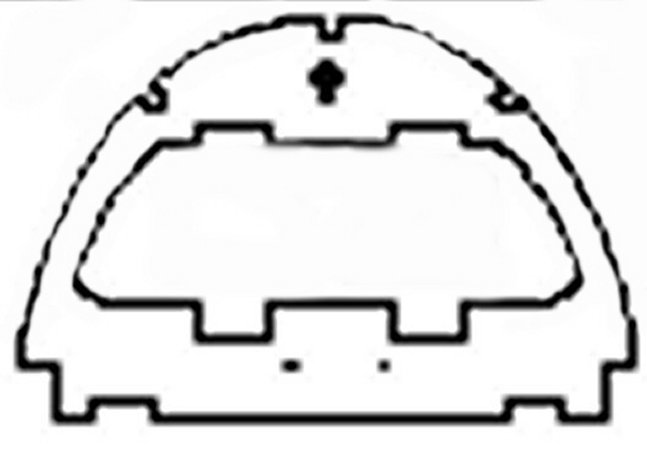

Next the Royal:
