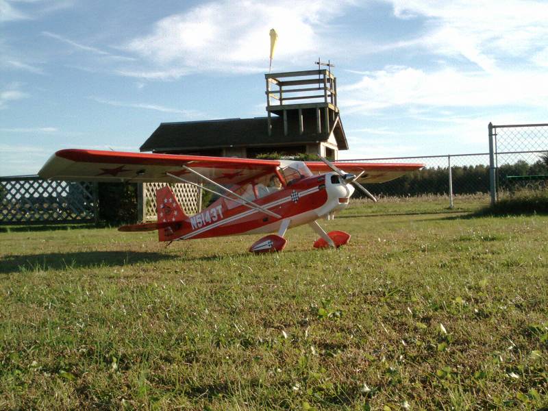

It's a shame that you can't get the spray cans of the Coverite paint to match Coverite's 21st Century Fabric anymore as it's the easiest to apply iron on covering I've ever used. This old Citabria was covered about 5 year ago with the stuff and it still looks great but I did use their matching paint for the cowl and pants! Something to consider if you can find/aquire the matching paint for your cowl and hard parts.

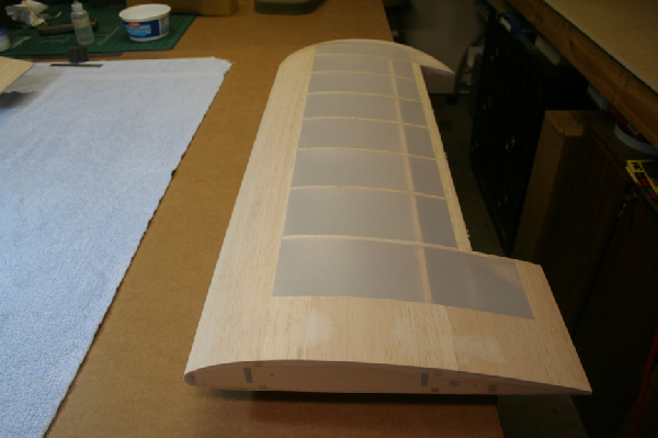

You are correct about the size. Either the dope or the Stix It work great. This stuff is nothing like any other covering that you may have used. It will stretch all wrinkles out on install and moving it around is not a problem with Stix or dope. Koverall will shrink a lot more than plastic coverings, so pay attention to the instructions not to use a air gun, just your normal iron will shrink it just fine.
I am finishing up a cub and have gone to Koverall applied with a latex liquid cememt called Mod Podge avaialble at Micheal's craft stores. Thin this product with water and seal the airframe, attatch fabric and fill fabric weave with two coats. No fabric sanding execpt along the cut lines of the fabric to remove fuzz just before painting. Painting with latex paints of course.

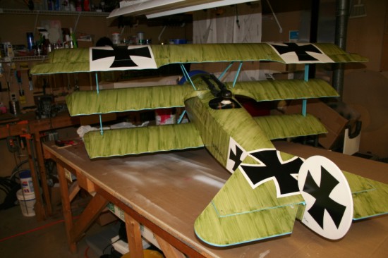

I used to use the Silk and Dope method years ago and then went to the Tex's. So Koverall or Tex on planes larger than .40's for me, .40 and under I use the Monocoat or other plastic (punishment) for building the under .40 planes.
For the Dr1 amd Bristol I used Solartex from BUSA painted with acrylic latex and sealed with oil based polyurethane for the yellowing weather effect. I am now just about ready to paint the Cub and plan on building a paint booth out of plastic sheet this winter to paint in. Should be ready to fly come spring. Best of luck with the Koverall.

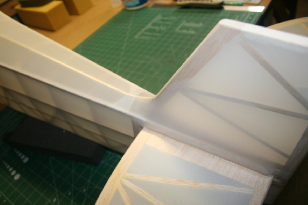

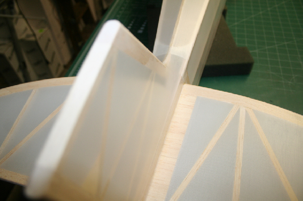

The Stix It is heat activated. You paint the Stix It around the perimeter of the area to be covered and let it dry, it drys very rapidly. Then place the Koverall cut oversize over the area and tack in place with your iron set on low. Experiment here as it does not take much heat to activate the adhesive and attatch the fabric, you want just enough heat to do that. Any more heat will begin to shrink the Koverall and you do not want to do that. You can move the fabric around by reaheating the area and sticking it back down just like you would any other adhesive backed covering. When you overlap fabric you will need to add more Stix It on top of the fabric that is being overlaped.
One thing I suggest is to seal the airframe using your choice of balsa sealer. One coat, light sanding and then another coat. I like the latex stuff (Mod Podge p/n CS11302 from Michaels Craft Store) because I can no longer tolerate dope, just to strong for me. Koverall is not as easy as the Tex's, but once you get a system going it is not that difficult and you will be rewarded with an awsume finish that refuses to do the Monocoat wrinkle.
Here is a picture of my work along with the vertical covering that I did in three pieces, top, left stab and right stab.
