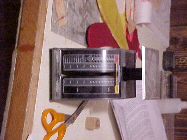

Old 10-12-2008 | 09:01 AM
Joined: Jul 2003
Posts: 2,261
From: Greensburg, LA
Default RE: What type of scale to buy?
any good postal scale. mine is good up to 2 lb. and they are not expensive at Wal Mart.
