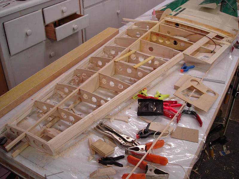

First I will say that I've covered a dozen or so planes so far & felt like I was getting pretty good at it. I am doing a repair for a club member on a Sig Sukhoi, the big green/cream one. He bought Sig covering (Aerokote I think).
I cannot get it to stick to the wood. I have tried various heat settings etc. Even got out my backup iron & tried that. I've NEVER had this problem with either ultracote or Monokote.
I'm trying to iron onto fresh new wood sheeting, not CA soaked or anything. Sanded smooth. Just as soon as I lift the iron the covering comes right back loose.
Any suggestions? wood sealer?[:@] It's like theres hardly any adhesive there.

A coat of Blasarite? and then sanded smooth. Tower Hobbies stock number: LXB355 $6.99..........http://www3.towerhobbies.com/cgi-bin...?&I=LXB355&P=7

El cheapo home brand hairspray works well in assisting covering to stick to troublesome areas, ply and epoxy.

A fellow clubmember told me to try the same thing. He was out of it. I treked clear to the next town to our local Hobby shop & he didn't have any nor did he understand what I wanted.[:@]
FYI, I took a scrap pc of ultracoat & ironed it to the exact same spot and had to work to get it back off, so I know it's the covering. I once again tried it with the same result. Before someone asks, I did remove the backing,, with the sig backing being clear it would be easy not too.

I tried it yet again, it just will not stick. I does shrink with the heat, just doesn't stick. We have 3 rolls of this for this plane cream/green/black, I used some green on the fuselage a few days back & it went on pretty good. I think this might just be a defective roll although some of it has been used. I think maybe it will stick to itself better than the wood? the pcs that have been used were for a fuselage repair patch.

Have you tried to adhere a scrap piece of the covering to something smooth and clean like glass or something to see what the adhesive is doing? Then if it is still working, try the balsarite or I think Sig has something like Stix-it or something for their covering. Probably obvious, but I would wipe the wood down with a tack rag too to make sure the dust is clear.

Yup, that is the stuff to use. Balsarite, or Stix-it. It might take two coats. Sig charged me over $22.- for a roll of AeroKote including the shipping charge. Have not use it yet as I have a lot of Ultracote to use up.

Return it to where you bought it from, or contact Sig. The product is defective. I doubt that you'll get any resistance for a refund or credit. Why wrestle with it?

As promised I will now report on the covering issue. Wed nite the owner came over to help decide what direction to go. Included in the choices were completely recovering the whole plane...new colors/scheme...pretty tempting but much work.
We decided to try something. I took a pc of the cream covering off the other end of the roll & it stuck....not good but it did stick. So we covered both sides of the rebuilt wing with it from the main spar back. It looks great in spite of the GREAT effort it took to get it to iron down right. Last night I finished the wing covering with the green color & it stuck much better than the cream roll. I think the roll I had was either really old or somewhat defective. It probably should have been returned but it seems like it will work, time will tell.
Since the top & bottom of this plane wing is virtually identical we changed the bottom side to cream/green stripes from spar back. Looks good. I had to remove pin stripes etc from the original side of the wing & they came off like a pc of cheap masking tape. The owner had previously bought a roll of red sig aerokote & wrapped the leading edge of both wings so it would be more visible in the air. One of those pcs blew off while he was flying a week or so ago. This was a pc probably 5" wide & 3 ft long wrapped around the LE. I removed the other one with little effort.
My conclusion is I hope I never have to work with Sig aerokote again, I certainly won't purchase any. But hopefully his plane will be back in the air soon. If this covering starts failing in flight it will probably get a total recover, the plane is worth it.
