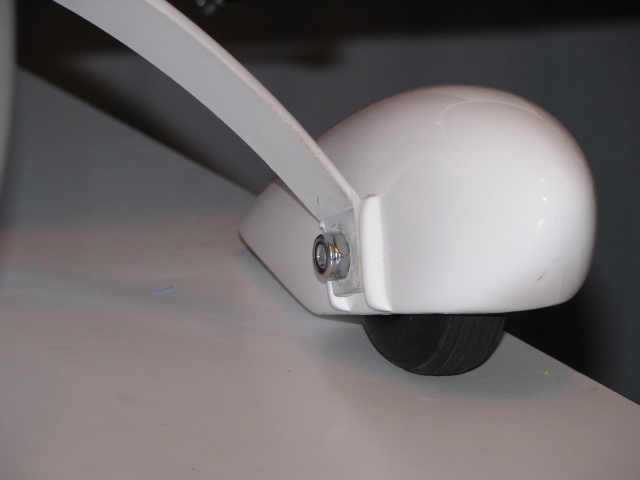

I use the Dubro comosite landing gear on the 4*60's I've build and killed. A nice touch is a set of wheel pants from a 60 size U-Can_Do. They are white fiber glass and should handle your wheels nicely. They have a set of lugs to lock into the landing gear and I have to cut the flats on the Dubro gear to fit. I then use the Dubro axels and bolt them together. If my fit isn't quite right, I use some epoxy between the gear and the pants to take up the slack between the lugs and the landing gear. Here are a couple photos of the pants and gear on a Ruperts Dad built from plans plane. I've got the same setup on a Great Planes Super Aeromaster and I used this on my last 4*60.
http://www3.towerhobbies.com/cgi-bin...?&I=LXBMP0&P=Z The wheel pants
http://www3.towerhobbies.com/cgi-bin...&I=LXNM65&P=SM The Landing Gear
http://www3.towerhobbies.com/cgi-bin...&I=LXD823&P=SM The axels
It is a cheap and good looking setup. Just paint the landing gear to match the pants, Paint both if you don't want white.

Darn it I fortot the photos
ID:	1090679   Click image for larger version

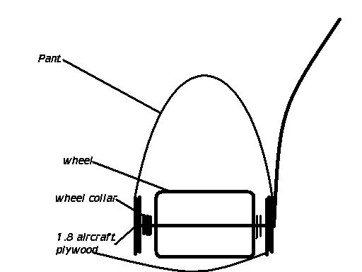

ORIGINAL: w8ye
Wheel pants and unpaved fields do not get along.
w8ye, while I have always read your post with great respect, I am going to be forced to disagree with you on this point. Nearly all of my planes have pants, and I fly off a decent patch of grass, that still has it's share of rough spots - even gopher holes. I have never had a pant break if they are installed with OUTER SUPPORT. That is the key to a solid pant mount. While i do wear the paint off of them sometimes, they aren't breaking or even cracking for that matter.
The attached diagram shows how I use poly-glued postage stamp sized plywood on the outside of the pant. The steel axle extends INTO this 'bushing', thus giving the outer pant support.

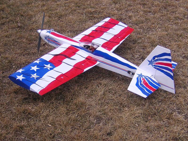

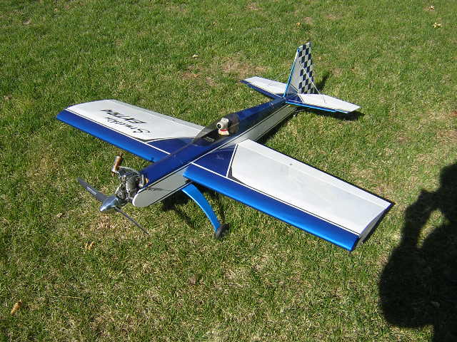

Old 12-16-2008 | 08:32 PM
Deadeye's Avatar
Posts: 4,516
From: Dutton, MT
Default RE: 4star wheel pants?
I should add that I use 1/8 aircraft ply on both the outside and inside of the pant. In the following pictures, the Extra has 200 flights, and is showing some paint wearing off. The Skybolt has probably 300 flights on it, and I cleared the pants enough, that the clearcoat is just showing signs of wear. The Cessna has only 25 flights, so it doesn't count. The Blue SE has 300 flights - no wear, no cracks (pics was taken day of maiden - pants added the next day). The American scheme SE only has 50 or so flights, so it's too early to see how they will last. But they are installed the same.
ID:	1091152   Click image for larger version
ID:	1091153   Click image for larger version
ID:	1091154   Click image for larger version
ID:	1091155   Click image for larger version
ID:	1091156   Click image for larger version
