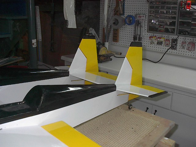

Just build bot elevators and rudders with counterbalances. Take it off the stabs and put it on the surfaces, very simple and very effective!
Not sure if you can see the lines with this picture of the one I built a few years back!

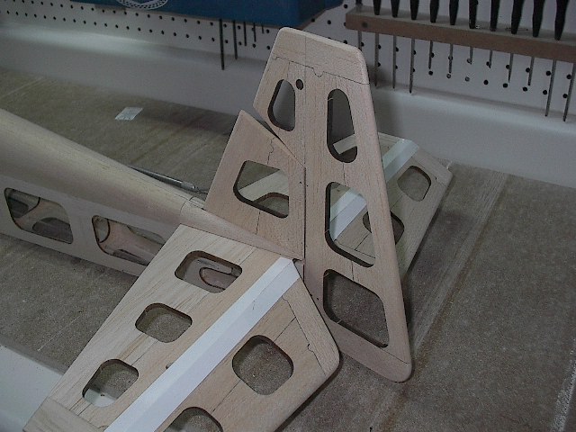

5. Add CB but leave area unchanged.
The pictures I have seen suggested that #5 was not an option as there was no good place to cut with the "holes" in the way.

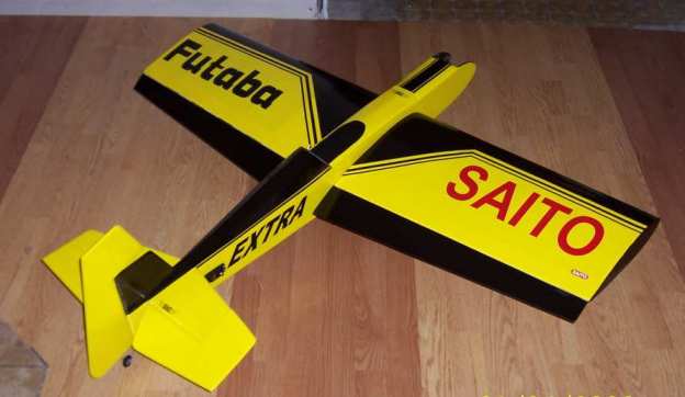

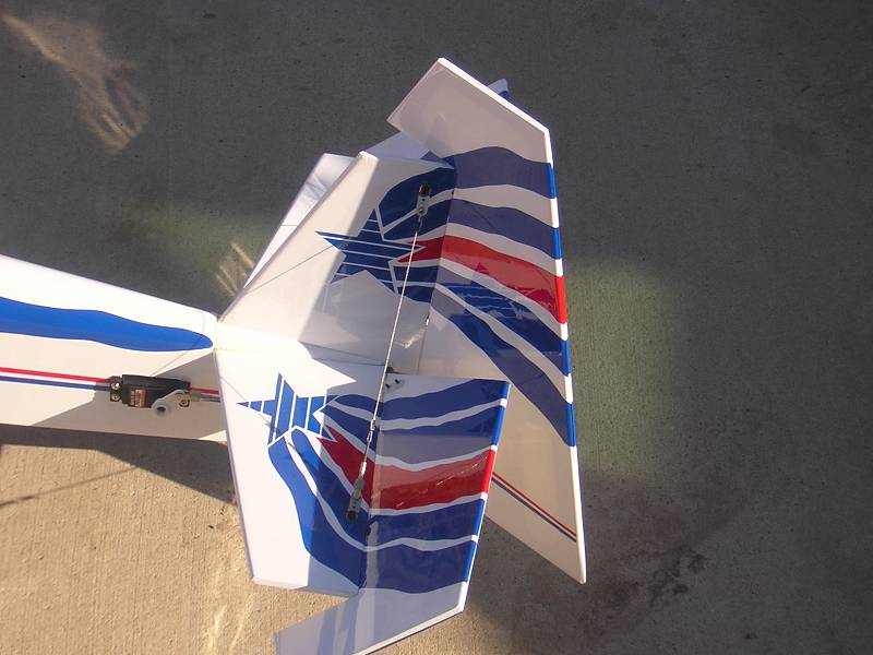

If you wanna knife edge, go with an enlarged rudder w/ counterbalances for sure. I made mine pull-pull. This is my third SSE.

I enlarged the rudder 1 1/2" on the back. I cut the fin short, just above the hole for the tail braces, and transfered that piece to the counterbalance on the rudder.

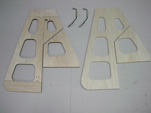

Iexperimented with bunch of ideas on the best way to modify the rudder and this one worked best for me overall. Cutting the rudder counterbalance at an angle really did make a noticable difference twin or no twin. Please be sure to post us some pics and let us know how whatever way you decide works for you....Damon
Now that's about the neatest thing I've seen yet. I never would have thought to cut the rudder like that for fear of losing some stability. Does it fly well aerobaticly? Maybe you could send us some video.
Old 01-07-2009 | 07:34 PM
Joined: Jun 2002
Posts: 375
From: Jacksonville, FL
Default RE: SSE: Rudder mod or not?

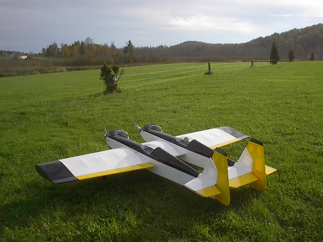

Thats what I thought at first but then figured it may even add stability to the structure by providing more counterbalance on the hinge line. Below is a picture of it flying. I also attached a picture of the first twin that also had the same rudder setup. The second one ate it on an engine out (engines too far apart). Sorry but don't have any videos.

Buddy that one really stands out in the sky. Must be a hoot to fly. I intend to build a second SSE if I ever get through with the first one (Too many other projects at home) and will add the rudder mod that you have done. By far that's the best one I've seen yet. The one I have now has the added width to the rudder and the CB added to the top above the vert stab. Going to run it with a Saito 65 four stroke. Might be a while before I get to try it though. Thanks for the pics.

Damon: Why diagonal? There is room between the cut-outs for a straight cut....
Old 01-08-2009 | 08:56 PM
Joined: Jun 2002
Posts: 375
I just thought it would look better. If it went straight across it would make the leading edge of the fin look a little funny.
