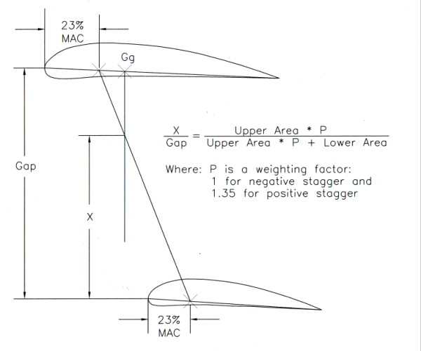

Steve: Be aware of, and watch out for, the shift it CG from wings of equal area, to ones of unequal area. This is from Lennon, and I have confirmed that it is consistent with several planes from different manufacturers.

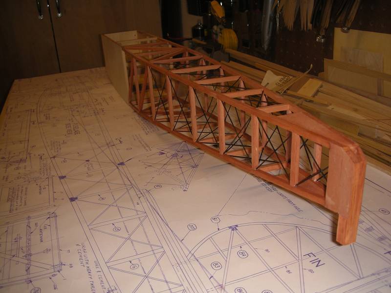

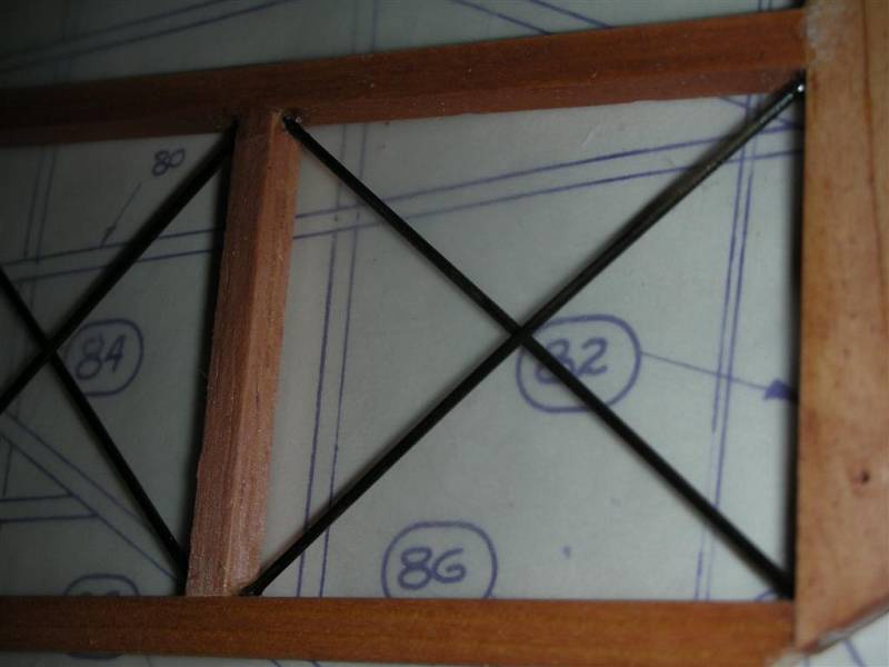

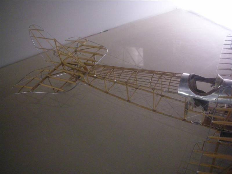

Once I got the ribs going, I started on the fuse. (I'm a week into the build so I'm still catching up on the thread) There are an amazing number of pieces in this kit, but the build is actually fiarly simple and very fun. I really enjoy building stick fuses, they just look so pretty. I first stained the rear fuse pieces with Proctor's Mahogany stain, and then piece by piece, the fuse side started to come together.
Things are really progressing now that I'm getting the knack for how the kit goes together. The second fuse side only took a day to build. The two sides are the same except the plywood veneers are added to opposite sides. The one step that I wasn't too sure about was installing the cross bracing which is made of small diameter bamboo. The first step was to paint it black (you can see it drying upright in a few pictures). While the paint was drying I used my dremel tool with a small drill bit to make a small hole in each corner where the cross bracing is to be installed. The bamboo cuts really easily with scissors. I cut it to length so it wouldn't bind and thanks to the small holes, it held in place even before the glue was added. I used Duco cement for securing the bracing in place. Okay, now I have two fuse sides completed!
I'm up to my current status now so more building to come in a couple days...

Steve, you are making great progress! The quality of the kit looks excellent. I may have to do a Proctor WWI after all!

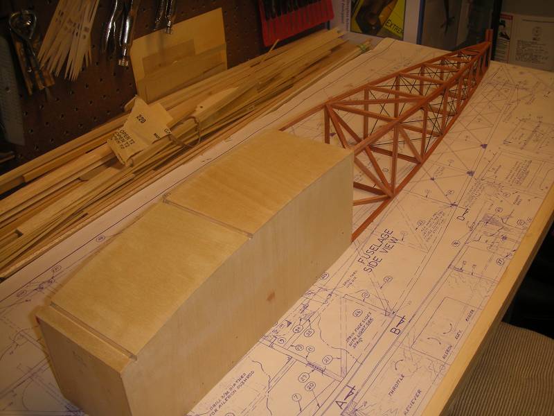

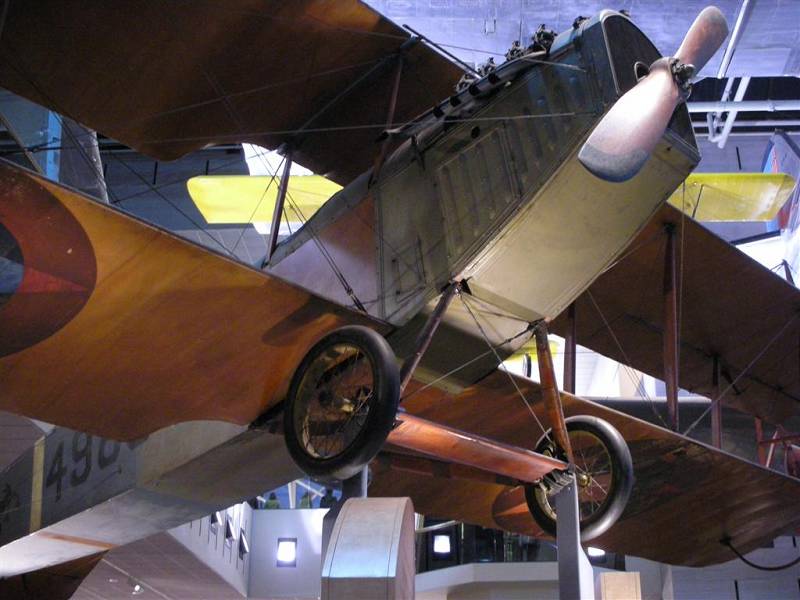

In my quest to stylize my Antic with some features of the Jenny, I checked out the Jenny on display at the Smithsonian Air and Space museum in DC. The nice thing about the Jenny that's on display is that it is cleaned up but not totally reconditioined. There were also some great Fokkers on display as well and the earlier models really resemble the stock Antic mono plane. One interesting observation a friend made was that the open fuse was typically used in the early years, but once biplanes were being developed the fuse was typically covered. This helps support my proposed mod of adding a turtle deck and covering the fuse, like it is in the Jenny.
The pictures don't do it justice but they will help me with the mods.

Your lucky you are so close by the Smithsonian. I was there last year but that area was undergoing a face lift so the Jenny was not there and I hate I did not get to see it. I like your idea to change the Antic some and have thought of bashing it into some WW1 type plane too. Looks good!

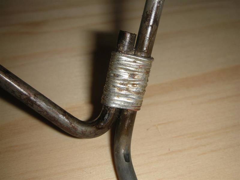

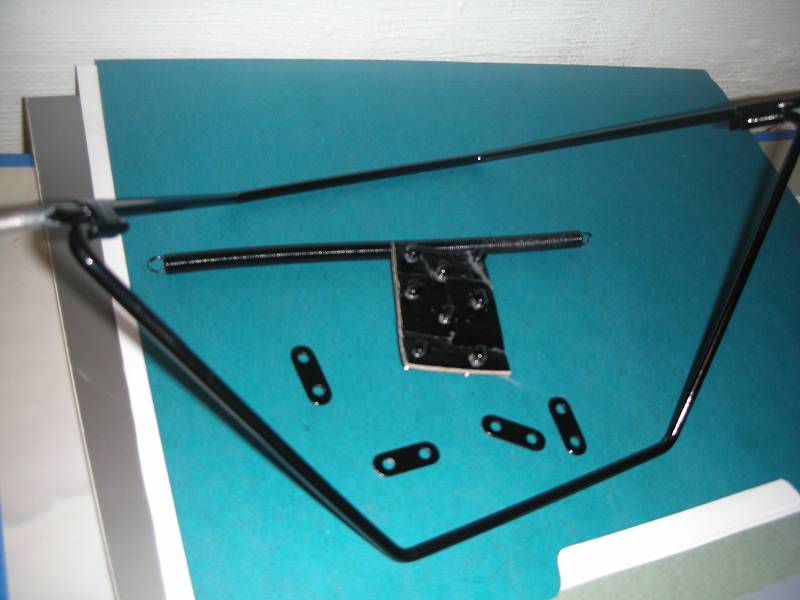

I mounted the landing gear last night and soldered the two pieces together with copper wire and solder. I used my wife's creme brule butane torch to solder the joint and it worked really well (as long as she never finds out). I'll be removing the LG to paint them black. The instructions call for mounting the tail skid but I'm going to hold off on that until after the model is covered because I think it will just get in the way.

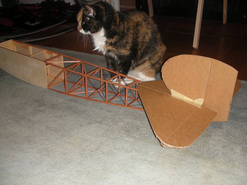

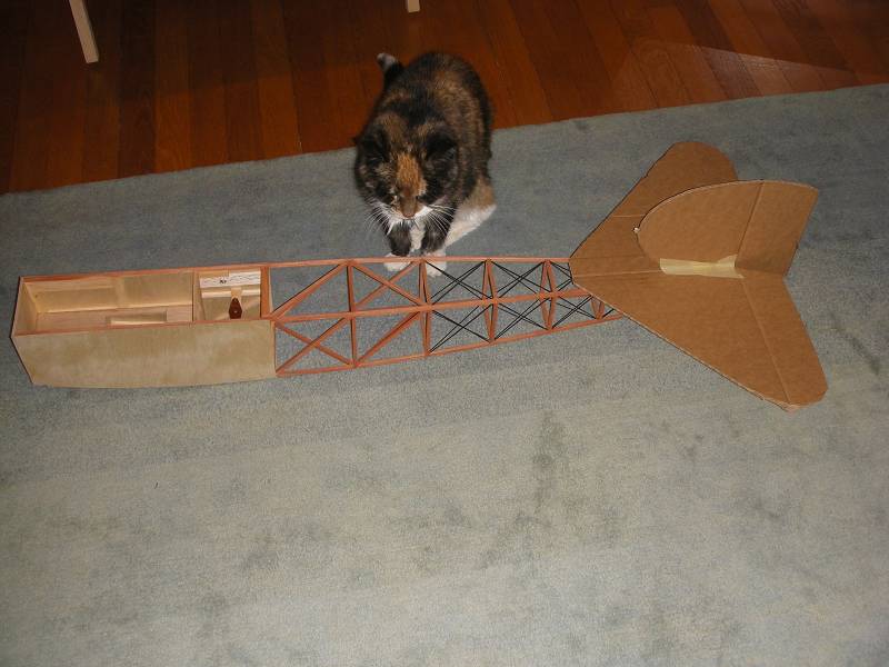

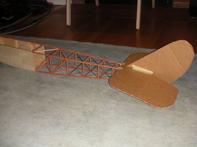

Here are pictures of the stock Antic and Jenny style tails which I fabricated from cardboard to get a visual on how things look. I'm going to think about things a little more before I finalize the tail, but my initial reaction is to make the following changes to the Jenny style tail: 1. reduce chord of elevator halves by 1 inche to get closer to the stock area, and 2. decrease the pointeness of the top of the rudder slightly and beef up the bottom slightly (I think my design is more pointed than it should be). I bought a bunch of stringers so once I get closer on the tail design I'll be able to start building the turtle deck and tail surfaces.
Steve

Hi lmcnii, thanks for the complements. This is my first Proctor kit and it is beautiful, so I'm sure you'll be impressed as well. To answer your questions:
1. I tried two types, the first being Tester's enamel that I had on hand that is typically used on plastic models. I wasn't sure if it would work but it adhered well and didn't bleed when I glued it. When I needed to paint more bamboo I thought I would do one better so I picked up some black acrylic paint from the hobby store. It applied to the bamboo easier but since it is water based it would rub off where the duco cement was applied if I wasn't careful. It's easy enough to go back and touch up, but I think I like the results of the enamel better.
2. The Duco cement seems to stick to everything so I didn't have any problems with it bonding to the stained or painted surfaces. I actually used Elmer's glue on most of the model so far and that also didn't have any problems bonding the stained wood.
3. Yup, but it will be open. I'm going to use 9 stringers laid on top of a few formers to build up the turtle deck. I'm concerned about tail weight so the stringers are pretty thin and there will be space between each stinger, just like the scale Jenny.
Have fun with the build and please share any pics!
Steve
Steve

I did not mention it, but your jig for cementing the cap-strips to the ribs is a nice touch also. Making one will probably be the first step for me when I get my Antic.
Hope your build continues to go well.
