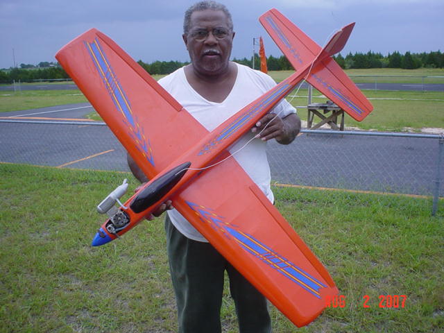

oh! don't let that ugly guy scare ya it's just me and my 40 kaos (before I smacked it)
