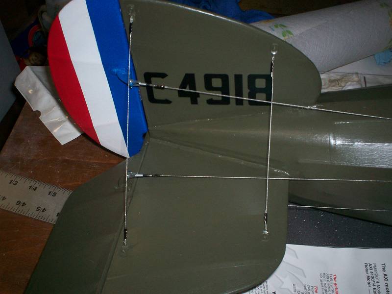

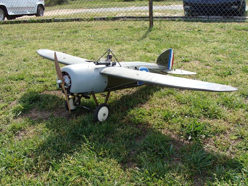

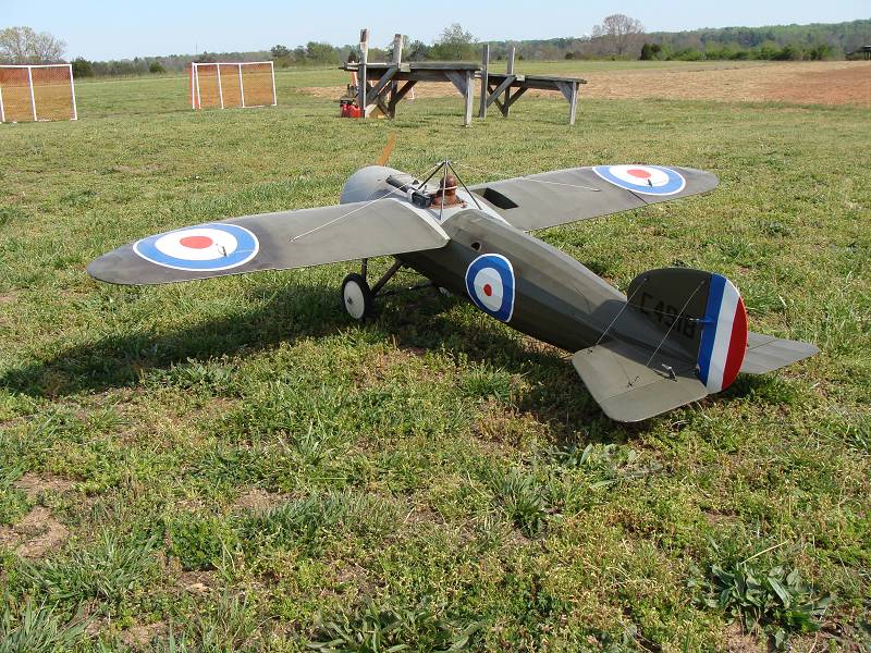

Mine flies great, the only issue is a sensitive tail, it doesn't take much surface movement to pitch or turn it. Part of that on my model comes from my increasing the H tail surface area and elevator area to make it more scale. But with a lot of expo, it's almost as tame as a trainer. I have an .80 Saito up front, so no lack of power.
One reason BUSA is vague on the prop hub to firewall distance is that the model will have a longer nose than the fullscale did, no matter which engine you use, so a specific distance doesn't really matter. The fullscale also had a dish-shaped spinner that almost occluded the area between prop hub and cowl. I've been told that the Albatross spinner from Arizona Models is a close fit for the BUSA Bristol.
I just used an acorn style prop nut, since the front of the plane is off scale anyway. I love my Bristol, a fun plane to fly, and it's pretty fast with the Saito and a 14-6 scimitar prop. Another thing, the size wheels called for in the manual is too small, use the next size up Williams Bros. wheels

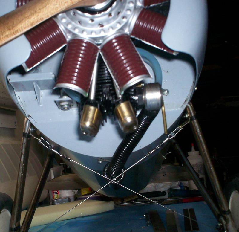

whoa nice bristol there! if you dont mind telling me,where did you get that nice dummy motor inside the cowl?
Old 02-09-2009 | 03:21 PM
Joined: Jul 2003
Posts: 5,587
Received 28 Likes on 25 Posts
From: newton, NC
Default RE: Balsa USA Bristol m1
ORIGINAL: caphead
It's from the Hangar 9 60 size Sopwith Camel. You can order it from Horizon, cat # HAN4234, about $6. You'll have to trim it to fit, it isn't perfect, but better than not having anything there.
