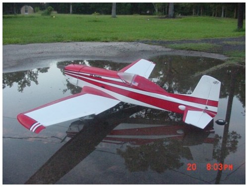

I picked up an Agwagon ( kit) already put together and it seems a bit tail heavy. It didn't come with the instruction book, so I'm wondering if anyone out there has put one of these together and knows how far back the CG is?

I have built, rebuilt and mod the Kyosho ARF's , awsome planes, but I know the plane inside and out, ect ect ect.
