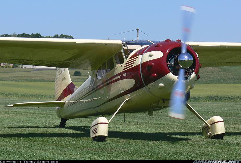

Glenn McIntosh and I are doing a C-195 dual build on RCSB http://www.rcscalebuilder.com/forum/...TID=12735&PN=1
We are just beginning, with a heavy concentration on our purchases and scale goodies for the Cessna. Actual construction pictures should be posted withjin a few days. Any modifications that we feel necessary will also be posted.
Come join us !!!
Here's the one that I plane to replicate.

Absolutely gorgeous. I'll be following along watching your build with pleasure.
John

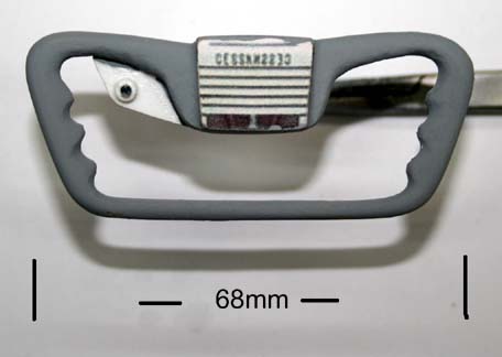

Glenn has completed the plug for the yoke. He's sending it to me, so I can cast some parts.

Nice yoke Tom. You do know that the PTT switch is an add on, never stock right?
Dave

ORIGINAL: av8djc
Dave
Glenn added the switch because we liked it. From what we can tell, there are very few 195s in original condition. Most cockpits have been upgraded to personal tastes,
