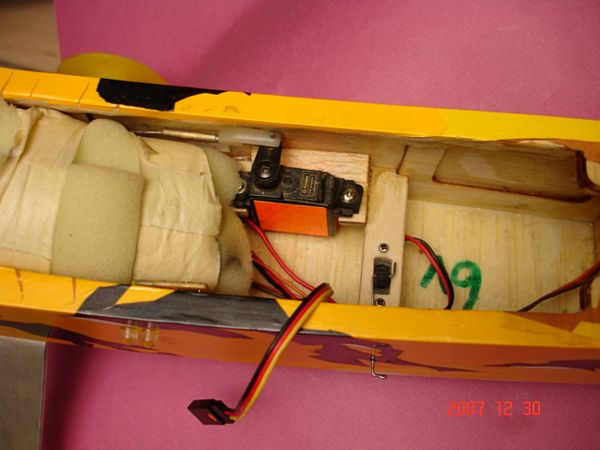

One method I use on all my models is to mount the switch inside the fuselage on a 1,5mm plywood plate and fasten a thin 0.75mm piano wire to it that goes out trough the fuselage side where I bend it back (L-shape). I finally solder a small small blob to the piano wire end. This On-Off switch just protrudes 0.5mm outside the fuselage and isn't noticeable that much.Se picture below.

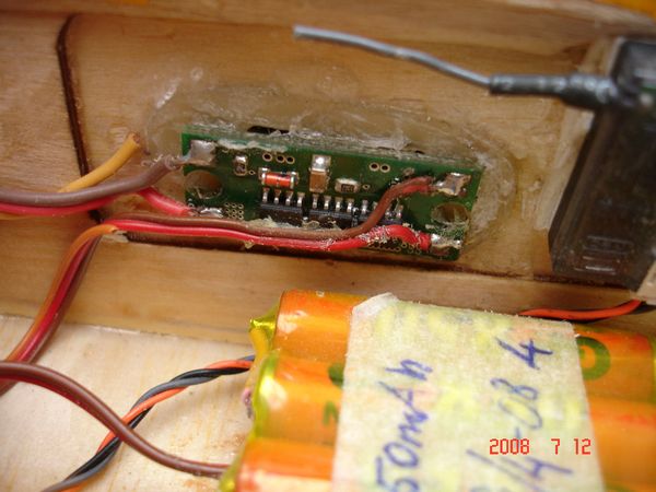

Then last year I saw an On-Off electronic switch that could be mounted inside the fuselage. It has two buttons. I mounted it behind the plastic covering (Oracover) on my Q-500 racer. Touch the plastic surface and it's ON ...touch slightly to the right and the switch goes OFF.
To know where the touch bottoms are I have marked the surface with small plastic film dots.

Old 03-07-2009 | 05:49 PM
vicman's Avatar
My Feedback: (10)
Joined: Dec 2002
Posts: 9,910
From: Valdese, NC
Default RE: Hidden Switch
I do the same thing with wire. I'm curious about the bump switch. What if you have a little rub during a race? Will/can it turn you off?
I also make mine push on for that very reason.
