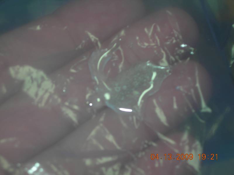

Good point. Thanks for the info. I was also thinking of bringing home some release film from work. It's made for carbon fiber work.

I'm going to bring home some release film and test it out. If it works with epoxies and CA, I have a winner. We use it for vaccuum de-bulking of carbon fiber layups and it peels right off the surface.

All very good ideas. I'm picking up a sheet of homasote tomorrow and mounting it to a hollow core door. Should work very well. I also got some of the professional quality release film and will test it with CA and epoxy tonight to see if it will work.

Ok, so I brought some high tech release film home today and did a couple tests on it. The CA had absolutely no effect on it. Matter of fact, it just sat on the surface like a drop of water and didn't even cloud the film, or leave a residue. Next, I mixed some epoxy and spread it on the film, let it harden, then removed it. It popped right off!! This stuff is gonna be great for building kits on. Gotta love the space program, good things come from research. Check out the pics. First pic is the epoxy on the release film, second is me holding that same puddle of epoxy after it hardened.

Here's a link for the release film, it's called FEP and only comes in rolls. It's the violet colored film .001 thick. Might be worth getting a bunch of your buddies together to buy a roll. This stuff is amazing!
