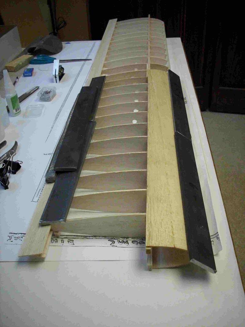

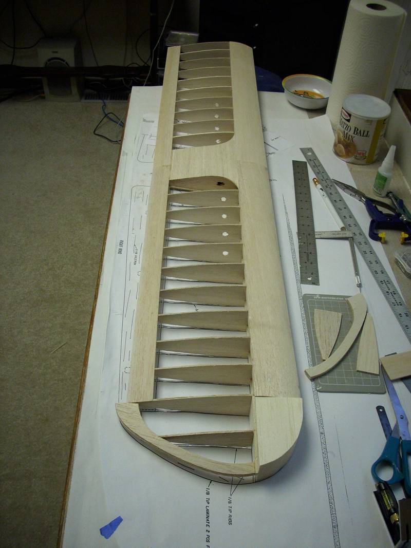

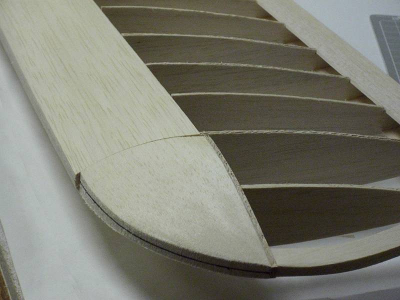

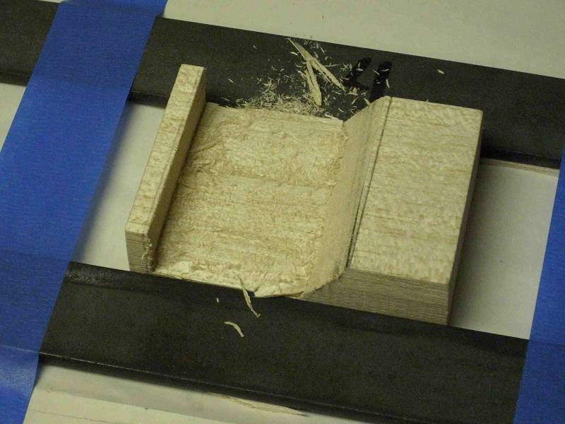

Ijust started the Smoothie - my first plane after 40 years. The balsa quality was good, die cut parts came out of the stock sheets very easily. Instructions areclear andeasy to follow. I'll continue to post pics as the project progresses.
Pics show the wing building, starting with wetting sheeting and using clips and weights to hold it in place. Last pics are of the wing tip install and partial contouring. I'll do the leading edge in a few days, Ifind that it's best to wait a day or two so that I have a fresh eye before doing something that can't be "un-done".

Yup that's just the way I remember it building, the smoothie is a really nice plane to build and fly. I see alot of people vote for the smoothie, so it might make it on the table next. I also have another kit to add to the list, an early 90's GP cap 21, 40 size, might find a nice rossi for that one.

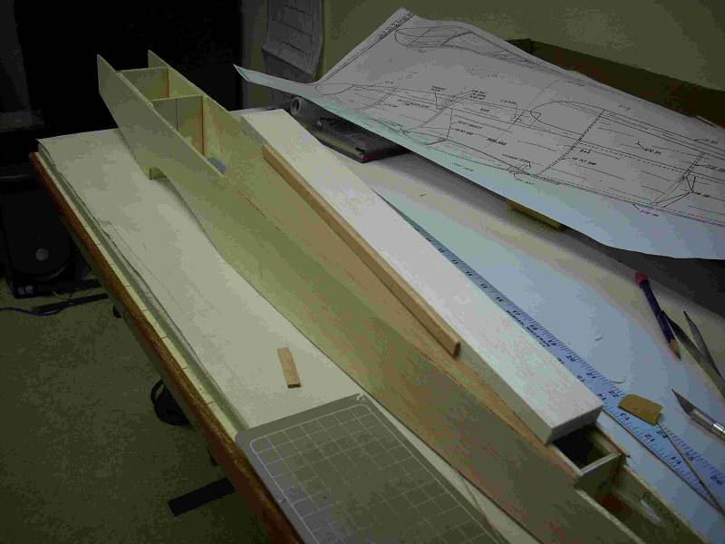

<p class="MsoNormal" style="margin: 0in 0in 0pt"><span style="font-size: 10pt; font-family: Arial">I've started the fuselage, no real problems. <span style="mso-spacerun: yes"></span>However, the middle former for the turtle deck did not fit well, so rather than trimming it (I didn&rsquo;t want to screw up any angles/alignments) I moved it forward about 3/4 inch where it seemed to fit perfectly &ndash; mistake.<span style="mso-spacerun: yes"> </span>I didn&rsquo;t realize that the angles of each turtle deck former were not the same, so when I put the top block on turtle deck sides I found that the former I moved had caused a slight bowing.<span style="mso-spacerun: yes"> </span>Rather than trying to sand the sides straight, I decided to use scrap and leave the bow as it was believing that this way I&rsquo;d at least keep all the lines flowing and not introduce a worse problem caused by sanding error.<span style="mso-spacerun: yes"> </span><o></o></span></p><p class="MsoNormal" style="margin: 0in 0in 0pt"><span style="font-size: 10pt; font-family: Arial"><o></o></span></p><p class="MsoNormal" style="margin: 0in 0in 0pt"><span style="font-size: 10pt; font-family: Arial">Anyway, pic 7 shows a piece of scrap glued in place to the top block, filling in the bowing.<span style="mso-spacerun: yes"> </span>Pic 8 shows the scrap piece and top block sanded to match the turtle deck sides.<span style="mso-spacerun: yes"> </span>Pic 9 shows the turtle deck bowing.<span style="mso-spacerun: yes"> </span>I&rsquo;ll sand it to it&rsquo;s final shape later.<span style="mso-spacerun: yes"> </span>Pic 10 is a close up of the scrap piece after sanding.<span style="mso-spacerun: yes"> </span>Next step is mounting the wing which I&rsquo;ll skip Pics unless some asks for them, and then comes the nose.<span style="mso-spacerun: yes"> </span>The nose should be interesting as there is a variety of ways it can be finished as &ndash; the engine will sit upright. </span><span style="font-size: 10pt"><o></o></span></p>

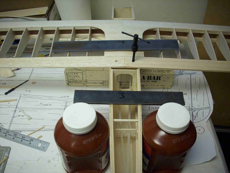

<div style="margin: 0in 0in 0pt"><span style="font-size: 9pt">Continuing the build with the wing mounting, cockpit and top block. I have limited tools, so I hand-carved the cockpit out of a single block and then used some 1/32 sheeting from a USS Missouri build to finish it. </span></div><div style="margin: 0in 0in 0pt"></div><div style="margin: 0in 0in 0pt"><span style="font-size: 9pt">Pic 11 shows the wing mounting/taping screw holes.Pic 12 is the cockpit being shaped using two flat pieces of iron to prevent over-carving and ensure everything is flat.Pic 13 is the cockpit after the 1/32 veneer.Pic 14 is the cockpit glued in place and Pic 15 is the cockpit glued and the top block mounted.</span></div><div style="margin: 0in 0in 0pt"></div><span style="font-size: 9pt">Next comes the engine install which needs to be done before fuselage shaping. </span>

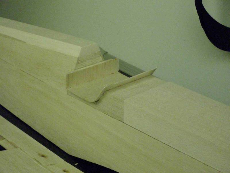

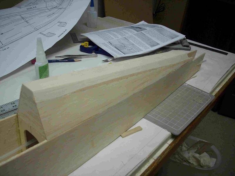

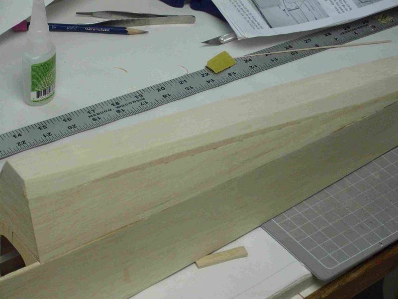

Continuing the fuseage build, it's about 90% complete, needing only final trimming, filing and sanding. There is a lot of carving/sanding, and the top block nearly gets sanded away at the nose. Idid have one accident, instead of using an OS .40 LA from a trainer, Iaccidentaly bought a new OS.46 AX - whoops!
