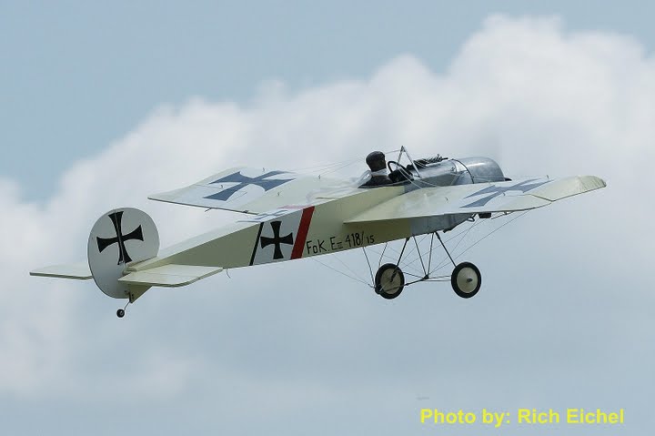

I've got a Balsa USA 90 size eindecker which I built and have flown quite a lot but not for a few months as engine bearings went.
Got a saito 90 twin fourstroke up front. I didnt add any weight but as I recall rx battery was forward.
No vices whatsoever. Flies in a very nice and scale manner with the 90 fs and sounds really good.
