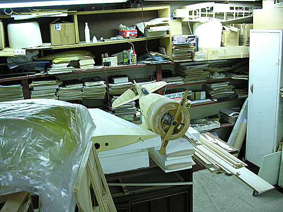

I'd also recommend using Spruce (or even clear close grained pine) for the spars. Be sure to put webbing between the upper and lower spars.
I'm in agreement with the above.
Charles

Charles</p>
You have quite a bit of work going on.  What keeps you from covering these nice builds?</p>
