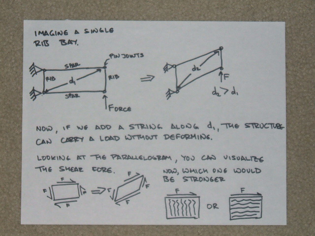

It has been an interesting discussion but I still think that there is some confusion about grain direction and the loads actually being carried. You need to keep in mind that wood is much stronger along the grain than across the grain. When you orient the wood so that the grain runs along the diagonal (not necessary at 45 degrees), the "shear" load is actually being carried in tension along the diagonal. You could in principle replace the shear webbing with cables or string running along the diagonals and end up with the same result as adding a shear plate. However, the last time I checked, cables cannot carry shear loads. I have enclosed a simple sketch which hopefully ilustrates the principle. The other thing to keep in mind is that the ribs on a model airplane has very little compressive strength and that is why it is better to have the grain oriented vertically. The links to full scale airplane construction techniques show that the ribs typically have vertical compression members where they meet the spars. If this is the case, maybe a plywood shear web at 45 degrees would be best. because it is crossed grained. At any rate, I think I will leave it at that and would like to thank those who posted the links as they make for fun reading.
Teo

If you consider the design of trusses used in a bridge; or, the trusses used in the roof support of a building, it becomes easier to understand the correlation with placing diagonal shear webs in a wing spar assembly.   In full scale (which Rodney is referencing) the additional weight of building spars in this way can easily be absorbed.  It may be that a spar built in this way might work for smaller models, also.  However, my opinion is that vertical webbing works well enough, why go to the extra effort?
Old 05-28-2009 | 09:44 AM

So, Ive been thinking about this a little and I'll go along with the Free Body
Diagrams that show that the shear web grain orientation, vertical or horizontal,
probably doesnt matter much if the webs are properly fitted and adheared to the
ribs. No gaps, air tight.</p>
However,
(#1) how many of us have built wings with the webs not even contacting the ribs?
The webs are only adheared to the spars. So you basically have, what was described
as, a shear crack on either side of a rib.
Id bet my lunch that in cases like that, the vertical grain orientation (normal to
the spar) is the only way to go. Id surmise that the compressive and tensile strength
of the webs become even more critical so that the web does not buckle under flight loads.</p>
With no rib in contact with the webs, a horizontal grain, has no glue joints to keep
the web from buckling under load.</p>
(#2) also a wing in flight under dynamic loads arent really comparable to a static truss.
The FBD's given dont consider the twist or torque imposed on a wing during flight (lift),
nor the torque imposed on a wing due to flap and aileron operation, nor...
the rotational force imposed on a wing just from ailerons and flaps would further the argument
for a vertical web grain orientation.</p>
The reason I had to add my two cents is that Id guess 90% of the planes Ive built and seen
built fall into the catorgory described above. I dont know many people that take the time
to build that "perfect on paper" wing.</p>
The grain goes normal to the spars.</p>
Cheers,
James</p>

"(#2) also a wing in flight under dynamic loads arent really comparable to a static truss. The FBD's given dont consider the twist or torque imposed on a wing during flight (lift),nor the torque imposed on a wing due to flap and aileron operation, nor...the rotational force imposed on a wing just from ailerons and flaps would further the argument for a vertical web grain orientation".</p>
First off, I agree with you, for the purposes of most R/C aircraft, vertical grain balsa shear webs work well enough. However, I question if they workbetter for the dynamic loads imposed on a wing during flight. I see the job of the wing spar assembly as exactly the same as a truss.</p>
Old 05-28-2009 | 11:58 AM
  #41
Posts: 496
From: Huntersville, NC
Default RE: sheer web grain orientation?
Yeah I see what your saying. A big typo there. I should have wrote:</p>
(#2) a wing in flight under dynamic loads arent fully comparable to a static truss with a single load.</p>
I dont disagree at all that the spar asm. isnt a truss. Ive read about wings folding because webs were accidentally omitted during construction.</p>
I believe if someone where to look at the FBD's given prior and then think about  a FBD showing rotational forces normal to the spar that the argument for webs with grain normal to the spars will still hold for my less than perfect wings with "designed in" shear cracks.</p>
I think you get the best of both worlds. OK truss strength with the rotational forces normal to the fuse and then good strength with the rotational forces normal to the spar/truss. With rotational forces normal to the truss and the web grain normal to the spar, the webs are probably at full effeicency in compression and tension.</p>
