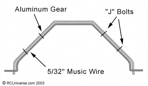

This little plane is fantastic!
It's one weak point is the landing gear. They are very weak. Consider beefing them up with a piece of 5/32 music wire held on with "J" bolts

Thanks Mike...I have a Hog Bipe that could use this solution too!
